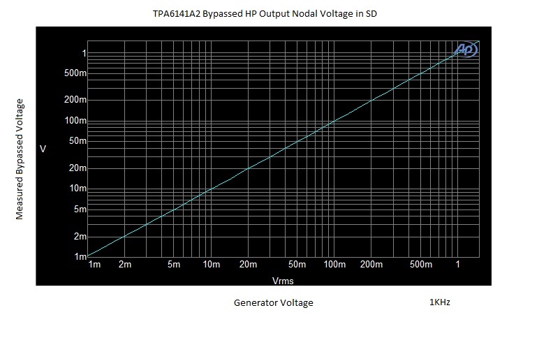

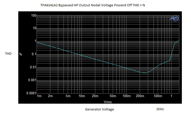

  • Hi Khaw and Branden,
    I have tried this use case the lab with a TAP6141EVM and have confirmed that using the part in this manner for both Shut Down mode and power disconnected will work.
    I have only tested up to 1.5VRMS and cannot confirm that it will work at higher voltages.
    First plot is in SD both measuring and generating a signal on the HP output.

    Third is powerd off voltage
    Fourth is Power off THD

  • Matt,
    Wonderful.  Thank you very much for looking into this for me!
    Branden
