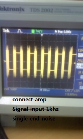

hi .

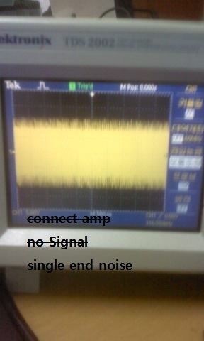

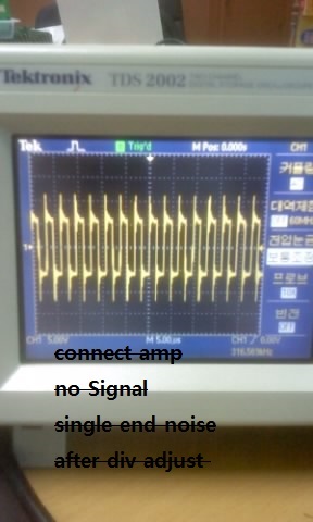

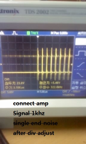

Noises from pin 27,28
How do I fix?

Can you please describe the issue more in detail? Maybe some waveform captures and issue description. Is the device function normally with expected performance?

Tpa3110d2evm is in use now.
c13.c19, ------>> 1uF
FB5, FB6 ------>> 33uH
After a change
Noise is reduced
the noise is emitted
After a change
Noise is almost reduced
However, when the speaker is connected to the noise 1/3 emission

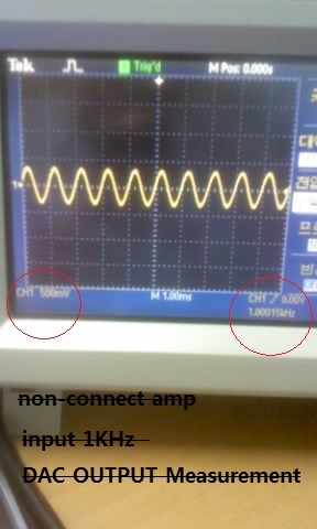

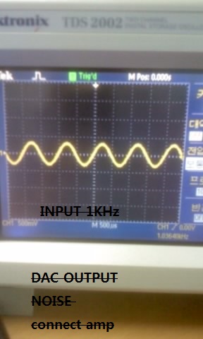

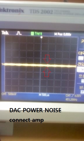

1. DAC output terminal is connected to the input terminals of tpa3110d2 occurs noise
2. DAC ground is connected to the input terminals of tpa3110d2 occurs noise
3. tpa3110d2 ground is connected to the input terminals of tpa3110d2 does not occurs noise.
Ground loop?
