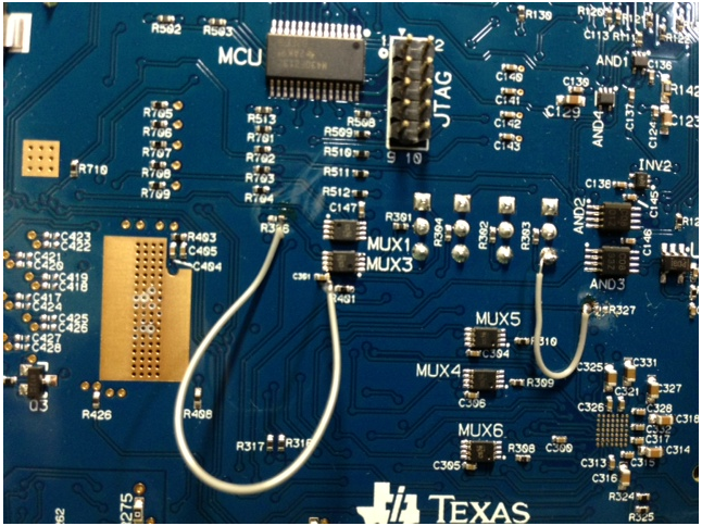

Could you please tell us whether TAS5754M evm operates with the 192kHz processing using the optical input?
If the components which is mounted on the PPCMB should be modified, could you please tell us this method?

Hi Damian-san,
Thank you for your reply.
Could you please indicate the schematics of PPCB which we should modify?

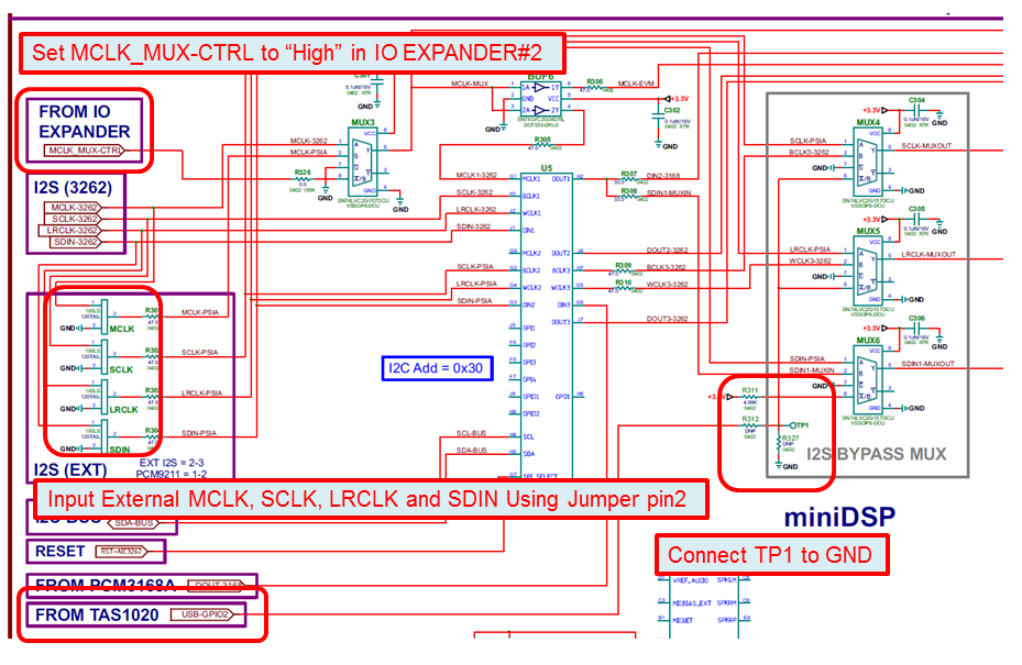

Kato-san,
The command to use the IO expander to control the MCLK_MUX_CTRL signal that allows to switch between EXT PSIA MCLK signal and AIC3262 as the MCLK source is given below. The command below can be executed in the "Commad Buffer Interface" field of the "Direct I2C Read/Write" GUI tab.
# AIC3262 as MCLK/I2S source
# Change to GPIO mode
i gpio
# Set bank 0
w 99 04 01
# Set bits (command 01) with mask 08 - sets P1.5 of Bank 0
w 99 00 20
# Go back to I2C mode
i i2cfast
# Set pins 21-24 as outputs
w 44 0E 0F
# Set pin 23 low (MCLK-MUX = AIC3262)
w 44 06 3F
# PSIA as MCLK/I2S source
i gpio
# Set bank 0
w 99 04 01
# Clear bits (command 01) with mask 20 - clears P1.5 of Bank 0
w 99 01 20
i i2cfast
w 44 0E 0F
# Set pin 23 high (MCLK-MUX = PSIA)
w 44 06 7F
Hi Damian-san,
Thank you for your response.
I do not need to modify the PPCMB by your advice.
