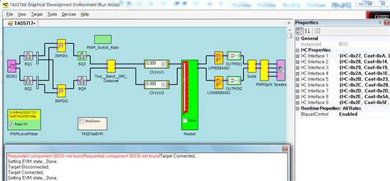

1. Please refer to the upper picture.
Requested component (BQ3) not foundRequested component (BQ3) not found.
Is this not support of BQ3 function?

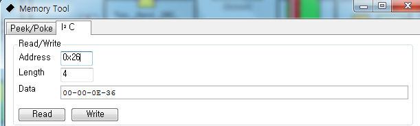

2. BQ1(0x26) & BQ3(0x27~0x2F) different from datasheet. But BQ2 & BQ4 is same byte of datasheet..
>datasheet : 0x26, 0x27~2F is 20 byte.
>GDE Memory tool, 0x26 is 4byte. And 0x27 is 1byte, 0x28 is 4byte.

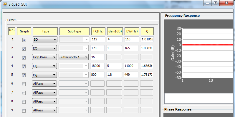

3.This is not menu I2C output value. First BQ setting table and I2C output value is only Memory tool inside.
Data value know is very difficult process I2C read(one by one read).
Please send us your comment.
