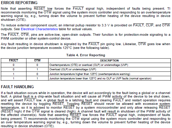

We understood that FAULT pin is asserted to low when detecting OTE, OLP, and UVP.
So, FAULT pin slowly changes to low from around 80℃(Ta) at the high temperature evaluation.
Could you please tell us the reason for this phenomenon?

  • Hi Kato-san,
    It sounds very unusual for the /FAULT pin to drop slowly in amplitude. It should either be high or low, since it is an open drain digital output. Did you observe an average voltage with a meter or other slow responding instrument? It might actually be toggling if there is a self-resetting fault, such as under voltage protection. I would not expect to see that behavior for any latched fault, such as OTP or OLP, unless your customer has set up an auto-reset circuit.
    The duty cycle of the toggling would tend to look like a slowly changing voltage, on average. You might be able to see this toggling on an oscilloscope. There is UnderVoltageProtection for PVDD, VDD, and AVDD. It would be unusual to see UVP for AVDD, unless something were powered externally from that pin.
