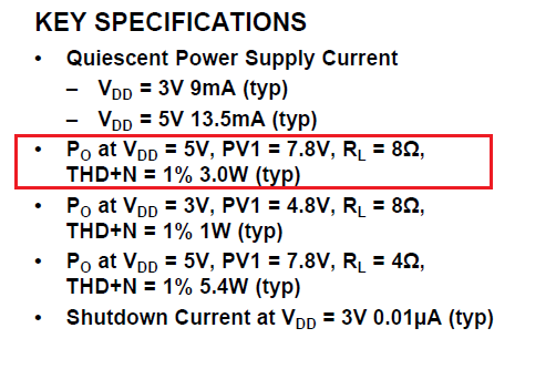

    I belevie you might have checked into the LM48511 datasheet, in which it says it would support upto 3W output into 8ohms at 5V with THD+N=1%.
    Am very well surprised upon why LM48511 cant be used to get THD+N<7%. Am I wrong in some basics? Please help me regarding this and let me understand the relation between THD+N and power supplied to it (Boost) and Load resistance.

  • Hi Shantharoopan,
    Take a look at the key specifications at same page and you will find the paragraph below.  The PV1 = 7.8V when Po is 3W with a 8 Ohm load, which means the boost is on.
