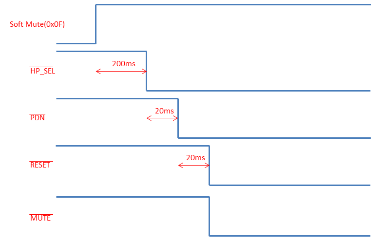

Our customer seemed the phenomenon that the output phase is adjusted by TAS5538 based on the power-off sequence.
The power-off sequence is shown as below.
Could you please give me your advice whether it is correct as that sequence?
In addition, does the phenomenon occur such as the output phase is adjusted in that sequence?
Please let me know as I send the customer's capture of the oscilloscope to your private e-mail if you need that.
