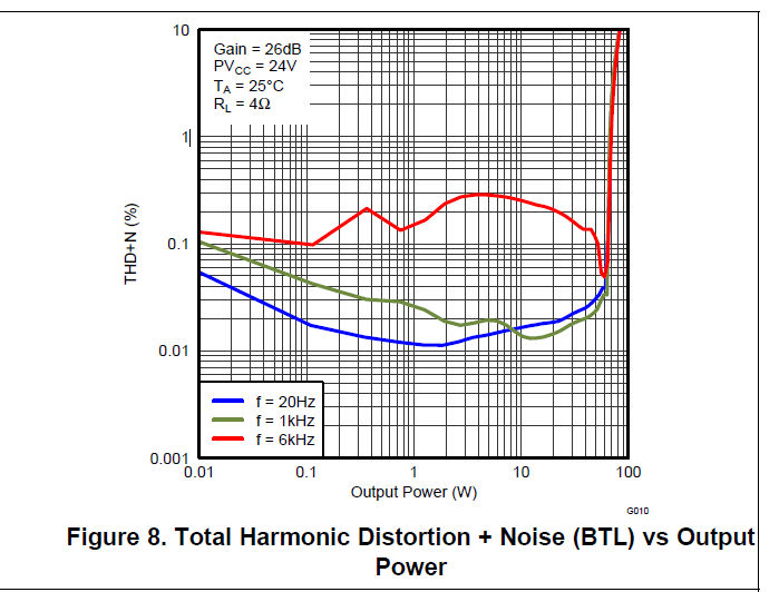

TPA3116D2 is rated at 2 X 50W at 4ohms load. what will be the power output at 8 ohms load in same config ?
Is it possible to get 2X50W @4ohms load at power supply 12V ?

Hi Roomi,
I see you have asked a similar question to your first one before. Please look at this post and let me know if it answers your first question or let me know what specifics you are looking for.
e2e.ti.com/.../1318492
As for getting 2x50W with a 12V supply. I do not see this as being possible. Referring to the plot on the datasheet on page 10, a 12V supply just simply is not enough to drive 50W. (I have attached the plot below.)
Mike
That is correct. Although, you may experience some distortion in your sound at that power level. According to the graph below the THD+N level appears to be around 10% with an ouput power of 75W.
Also, be sure to note that the datasheet does advise using a heat sink on anything above 2x15W for a 4 ohm load.
Mike
