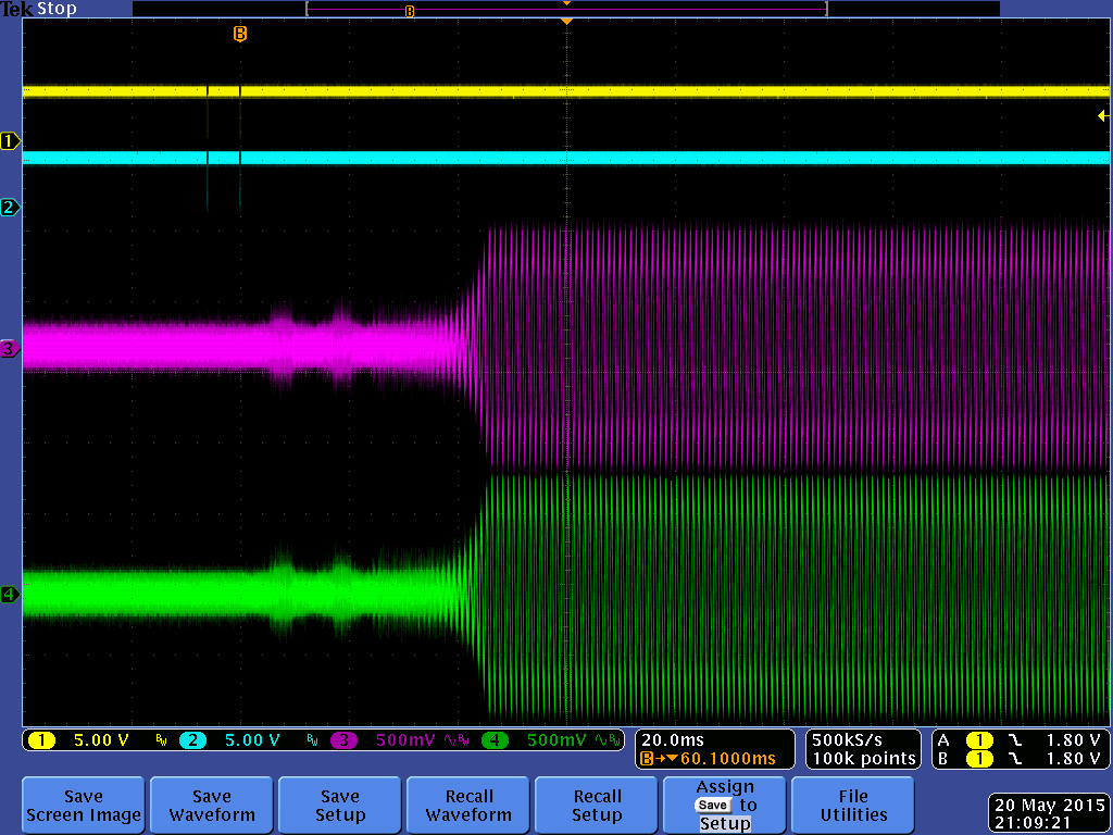

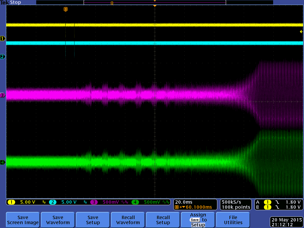

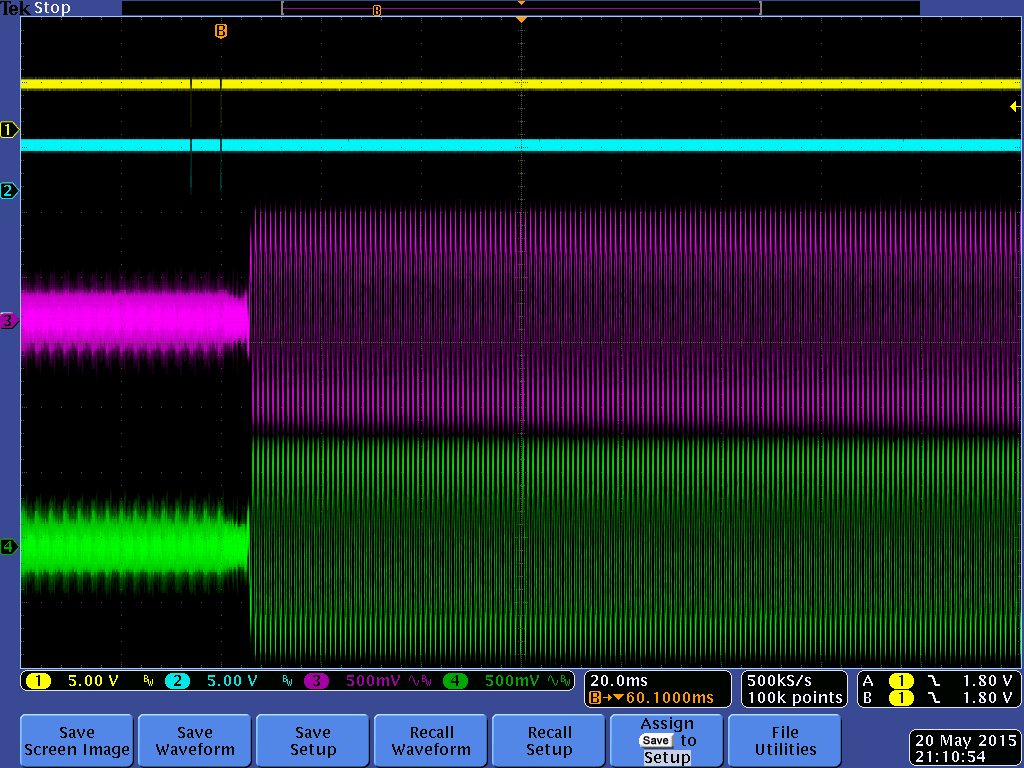

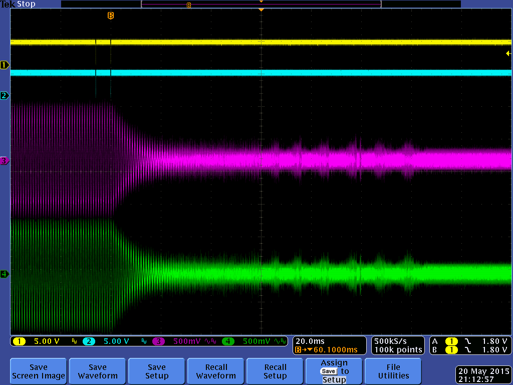

Could you please tell us the proper gui configurations for the tabs of "Volume Fading" and "Volume Change Speed" if verifying only the volume fading function with TAS5760M ?
We have evaluated all combinations as the following(Yellow:PBTL/SCL, Blue:FREQ/SDA, Pink:OUTA+, Green:OUTA-).
Non Zero Crossing / Executed at each LRCLK / Unmute
Non Zero Crossing / Executed at each LRCLK / Mute
Non Zero Crossing / Executed at each 8th LRCLK / Unmute
Non Zero Crossing / Executed at each 8th LRCLK / Mute
