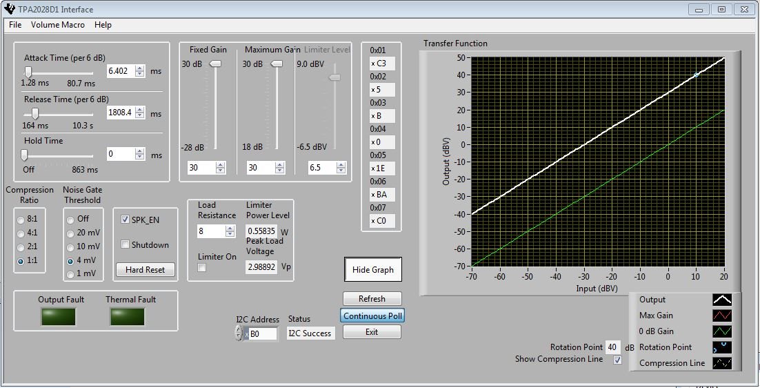

  • Hi Diego,
    I reviewed the evaluation board this morning and I have a few questions regarding the results of initial testing. My procedure was the same as on my platform: Set the compression ratio to turn of AGC, turn off output limiting and then adjust fixed gain. See the screen shot below for the settings.
    I noticed that when I set the fixed gain to max (30dB), over the course of several seconds, the volume increases. It appears that the volume slowly increases up to the value of fixed gain as I repeatedly play a sample sound. Could you explain why this change is occurring? I was under the impression that by disabling the AGC, the amp volume could be directly set by fixed gain. To what can I attribute this change in volume?
    Thank you for your help,
    Zach
