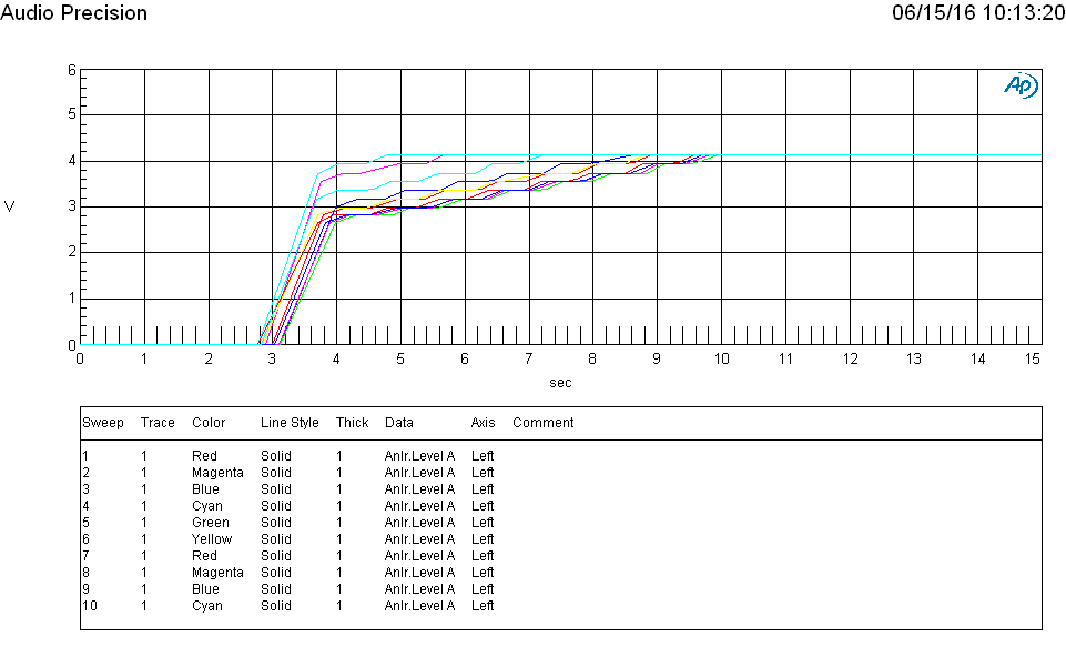

My customer is asking why output of TPA2015D1 is gradually increased even with fixed gain on from start-up.
I thought input might be cause of issue, but I found I can reproduce the issue on our EVM with AP audio analyzer.
Input: 1kHz 1 Vrms(UNBAL), Gain: 20dB(High), AGC: Open, Vin: 4.2V(Power supply), END pin low=>high at about 3 seconds during sweep
From my understanding, AGC pin open means disabling AGC function, but it looks gain is increasing just like AGC release on start-up.
I tried 10 times as below sweep graph, and it takes about 6~8 seconds to get proper gain.  Is it normal operation?
Could you help me to explain this to customer?

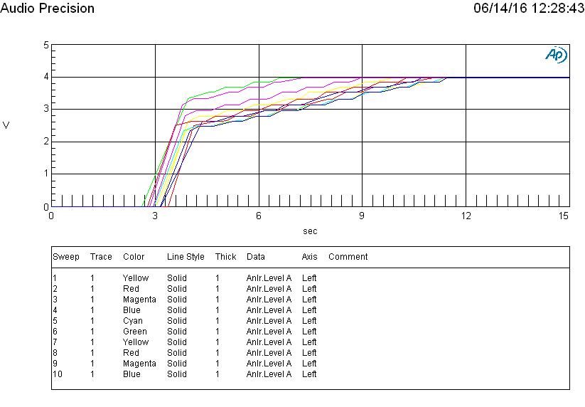

  • Hi Kenneth
    Have you tried to disable the AGC function tied AGC pin to VBAT? because It is another way to disable AGC function.
    Best Regards
    Jose Luis Figueroa
    Audio Applications Engineer | A-Team
  • Hello Jose,
    I tried AGC pin tied to Vbat, but it looks same. 10 times test result is attached as below.
  • Hello Kenneth
    I have searched and it is normal operation of the device. When AGC pin is left floating or connected to VBAT, that just disables the inflection point, It means that the limiter level is kept constant over all supply voltage. You could refer the Battery Tracking SpeakerGuard subsection in order to find more information.

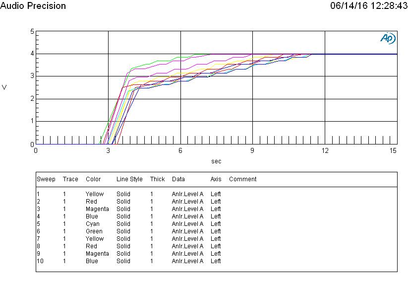

  • Hello Jose,
    Gain is 20dB and input signal is 1Vrms unbalanced.
    I guess TPA2015D1 output is recognized high enough to activate limiter on start-up even with this constant level input.
    There would be some unknown mechanism or internal process on start-up I think.
    Thank you for your answer.
  • Kenneth,
    I have performed some tests to our EVM and this kind of start-up is part of the AGC that is working correctly.
    You should take into account that the AGC can't be disabled, you can just change the inflection point.
