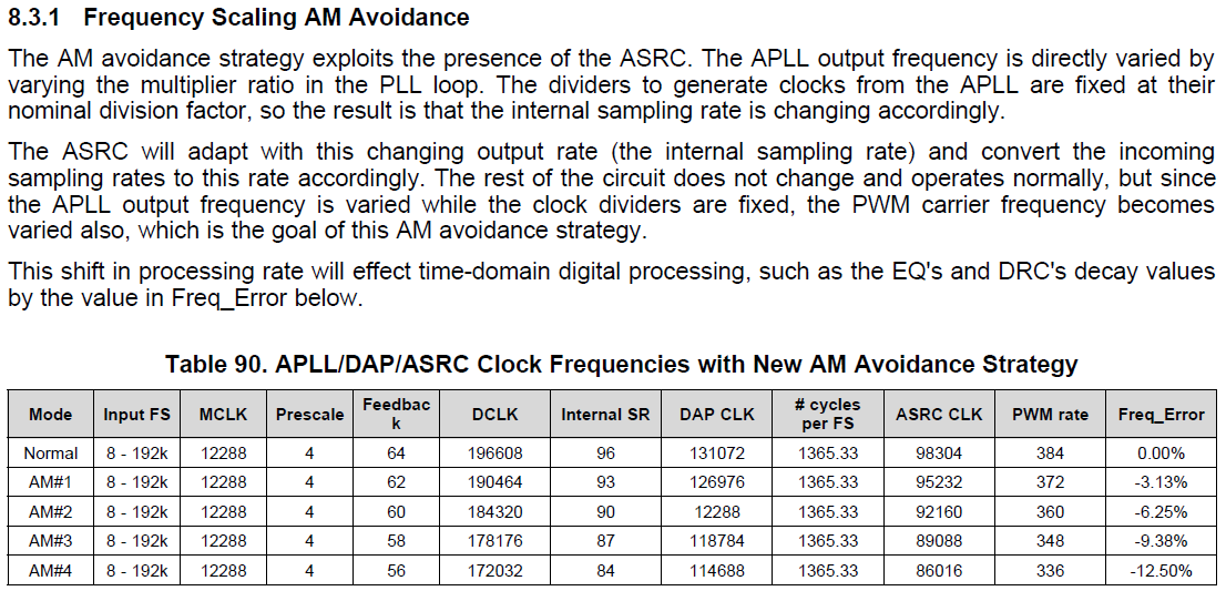

    By the way, I checked below description of TAS5558 datasheet .
    Is this the same as TAS5538?

    could you let us know the function of D24 and how to select D24 bit?

    Yes AM avoidance can enabled using 0xDE = 0x00 14 05 94. This selects:
    • frequency scaling of the APLL for AM avoidance,
    • Enables AM mode, select sequence 4,
    • selects IF frequency 455kHz (of the AM reciever in the radio)
    • uses BCD for tuned frequency and
    • set the AM tuned frequency to 594kHz
    The Sequence:
    1) Test order  8*Sample Rate, 7* Sample Rate, 9*Sample Rate, 6* Sample Rate
    2) Test order  8*Sample Rate, 9* Sample Rate, 7*Sample Rate, 6* Sample Rate
    3) Test order  9*Sample Rate, 8* Sample Rate, 7*Sample Rate, 6* Sample Rate
    4) Test order  7*Sample Rate, 6* Sample Rate, 9*Sample Rate, 8* Sample Rate
    These are the selected order of the PWM frequency used in AM avoidance algorithm testing. If first fail test then next PWM frequency is tested until a passing PWM frequency is found.
    Frequency scaling is discussed on page 107 of TAS5558 d/s.
