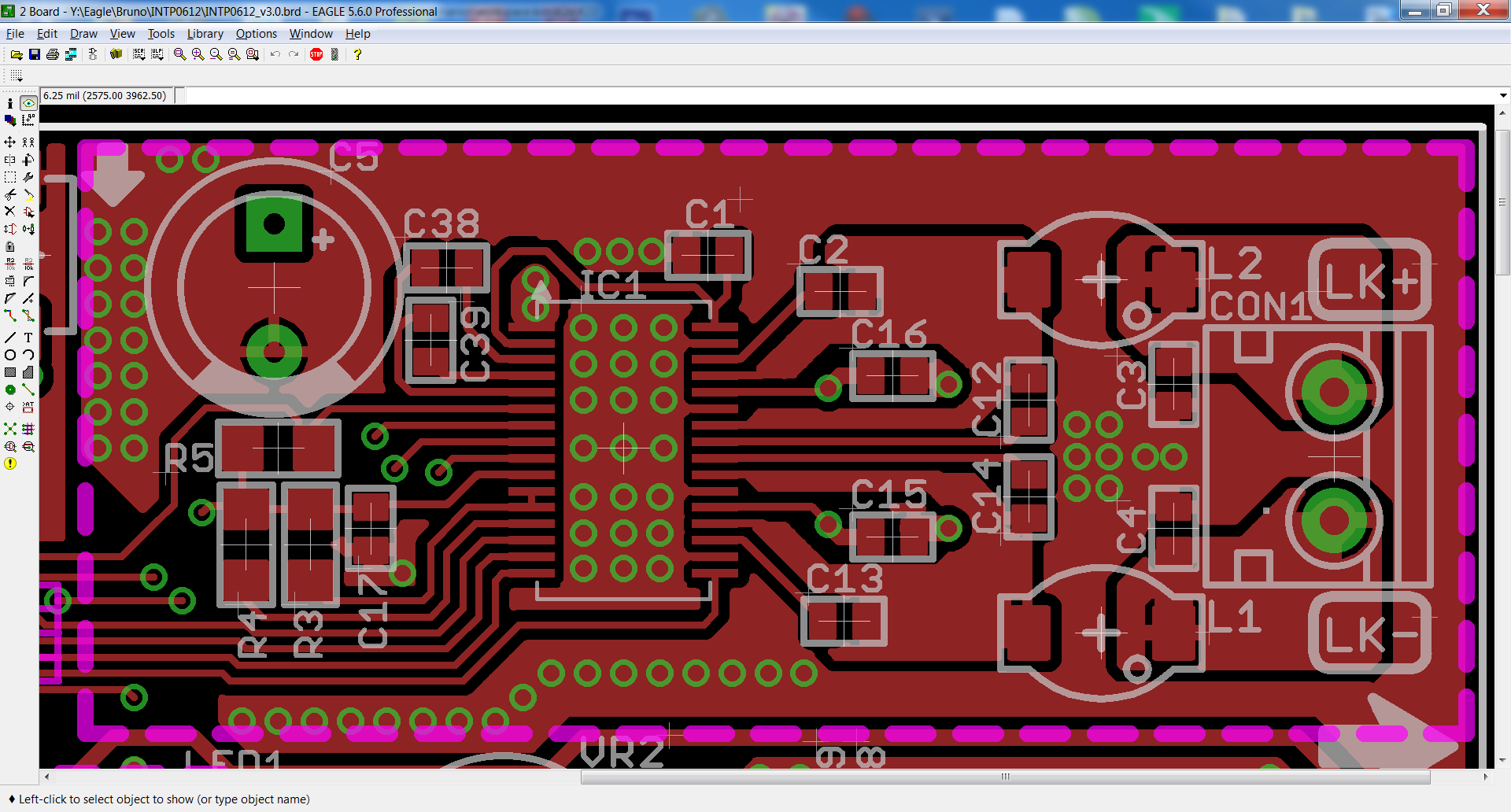

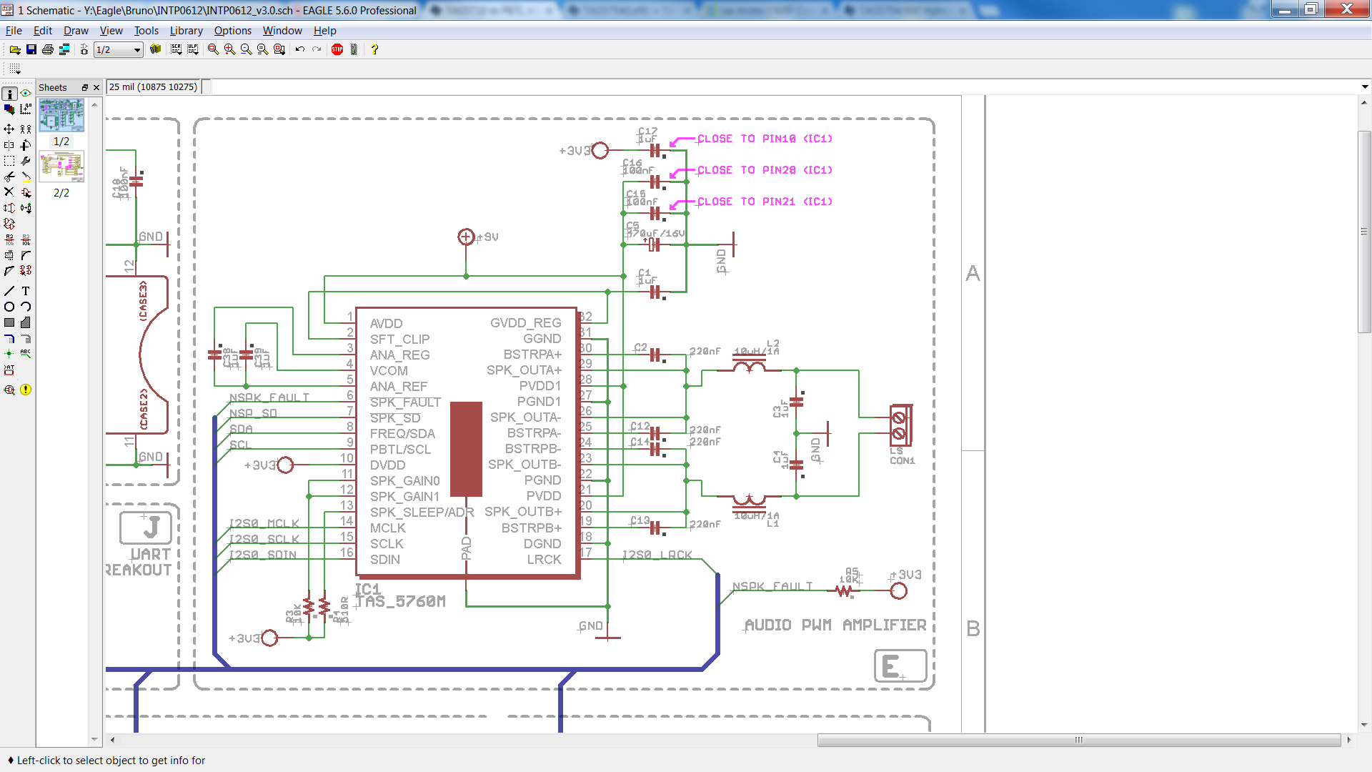

We developed a board using TAS5760M designed in PBTL mode MONO ,software control, working with the 32-Pin DAP package.

Also please check the attached images of the ".brd" and ".sch" of our PCB and mention if any problem occurs from wrong in its design.

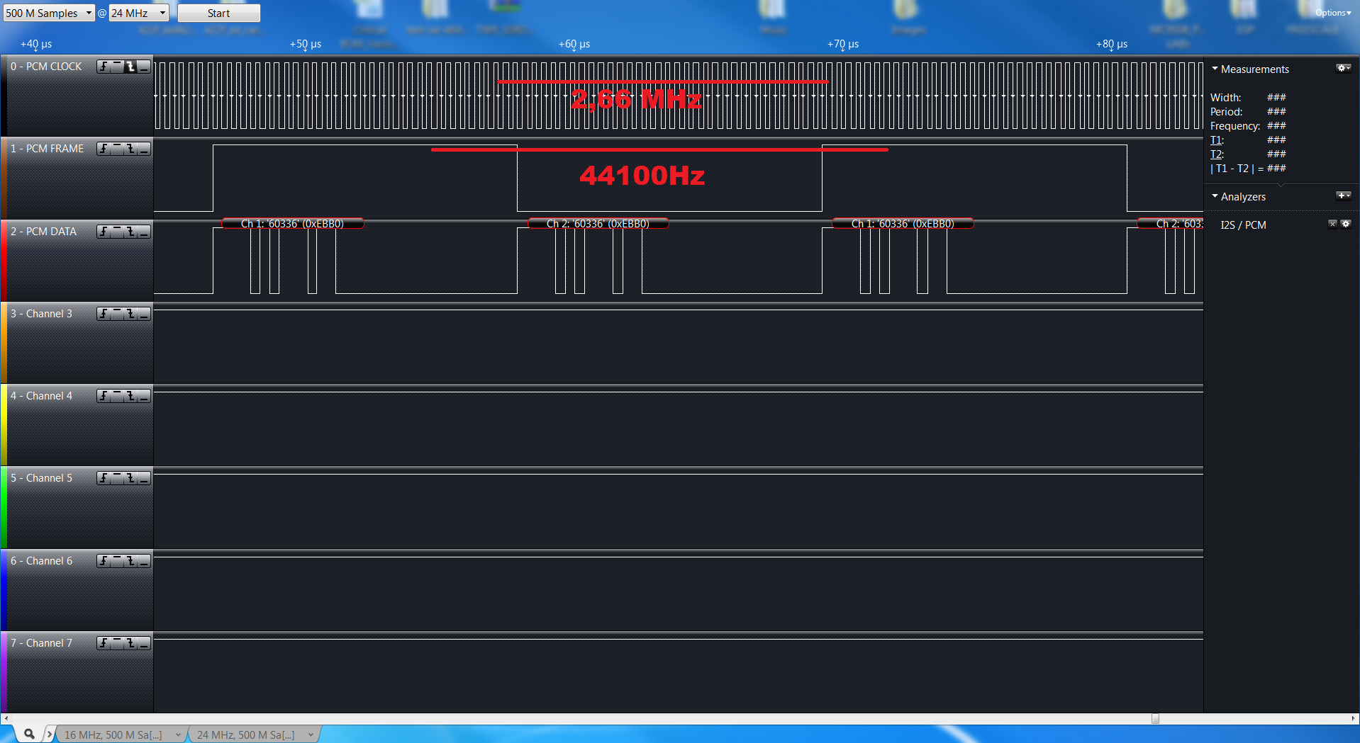

    Thanks for the information. The configuration of the amplifier seems correct. For the I²S format, It seems correct, but I would like to ask if you can send me the plots of the signals provided in your system so I can verify that they are compliant with the clocks expected by the amplifier. If the I²S signals were tested before in the EVM, maybe something in the PCB of your system is not correct.

  • Hi, Diego,
    I attached a screenshot of the I2S timings diagram that i monitor through a logic analyzer. Let me tell you that is the second time I have this problem,
    on 32-DAP package. You can check here (https://e2e.ti.com/support/amplifiers/audio_amplifiers/f/6/t/523152) our last post on the same problem that also not solved.
    +MCLK 5,66MHz
    Unfortunately, I am skeptic especially about 32-DAP package (mayby don not work at all) because I use exactly the same timing diagram to the 48-pin package exist on the EVB and works perfectly.

    Thanks for the feedback. I tested the EVM and provided same MCLK, LRCLK and BCLK from your timing diagram and the amplifier is shutting down while reporting a clock error. Can you please let me know the exact setup you used when testing the EVM? where did you connect the I²S signals?. Probably the amplifier is not accepting the BCLK/LRCK ratio. Do you have a different I²S source available to connect to the board just to discard any problem with your actual I²S interface?

    Seems that something goes wrong with your EVB, while I run again my EVB based demo and the result as for the I2S timing diagram it was exactly the same. Please find attached bellow.
    +MCLK =5,66Mhz
    Also the I2S signal must be right. I use exactly the same I2S channel on the microcontroller without change a piece.

    Can you please check twice the routing on the PCB I send you some days before?

    Luckily the problem wasn't occurred neither of the Hardware PBTL configuration nor Software setup, BUT I had  a very Critical Circuit problem on the pin of the SCLK which I fix.
    The logic analyzer was monitoring the same timing diagram but the TAS was returning Clock Error because of a short connection on the printed circuit on the BCLK pin.
    I would like really to thank you for your interest that you show at the problem with quick and helpful information. Also please accept my sorry for spending your time in a problem that I had to solve alone with double checking of the PCB.
