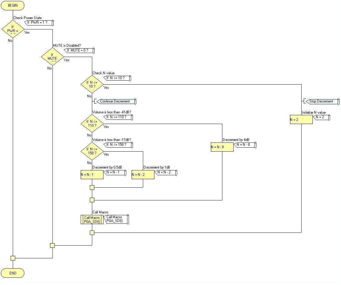

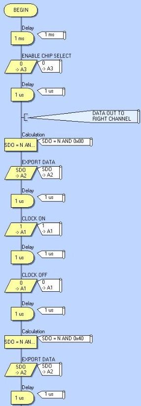

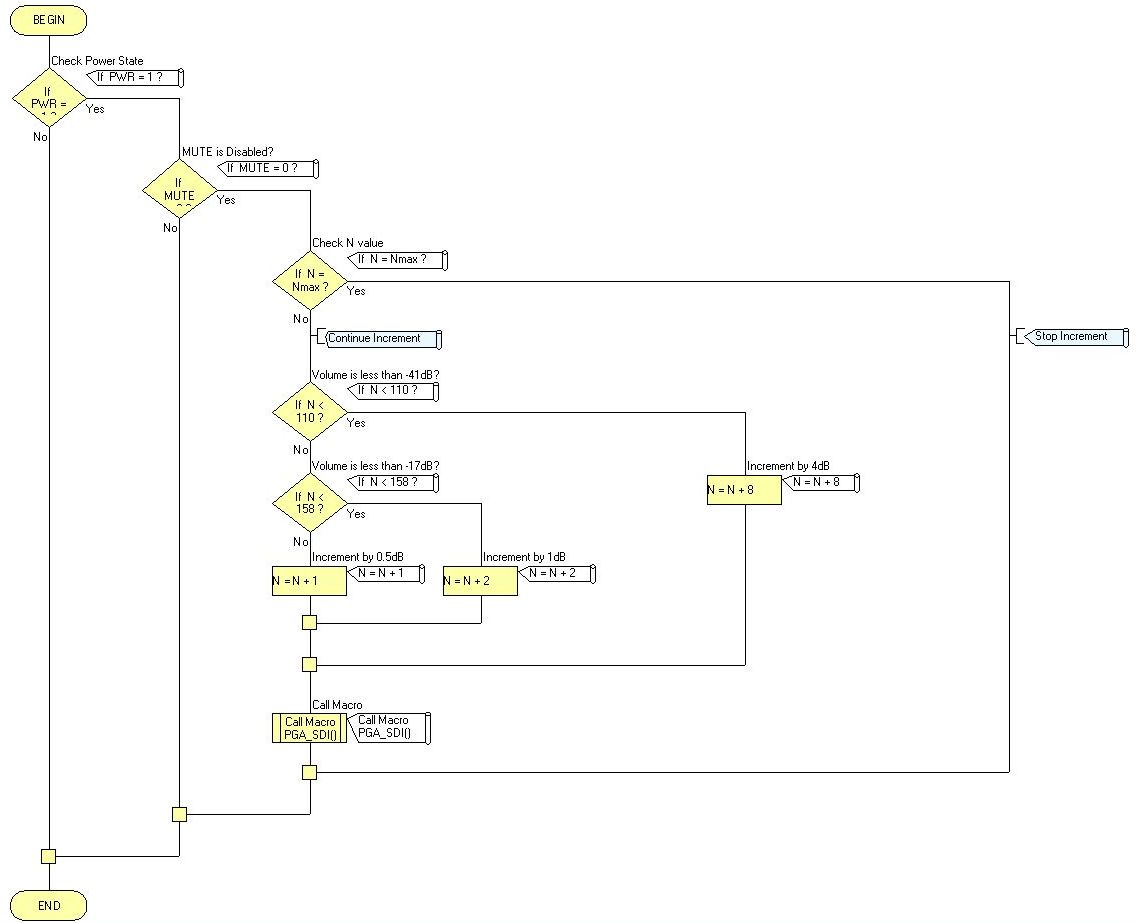

    Here is some code from my project that could offer you some ideas. Please note that i don't use the SPI interface of micro because is not available as i also use the I2S ports. For that reason i have obtained a custom code to provide controll on PGA2310 through the ports of micro RA.1=SCLK, RA.2=SDI, RA.3=CS. For code development i use the FlowCode graphical programming language. In the 1st picture is presented only a part of PGA_SDI macro as the rest steps to obtain the full gain byte are simillar.
    1) PGA_SDI:
    2) VOL_UP
    3) VOL_DOWN
    In VOL_UP and VOL_DOWN macros, you could see how the PGA2310 is encoded to simulate the operation of a logarithmic analog audio potentiometer. From actual tests the encoding of PGA to work in linear mode is inconvenient as the distance between the minimum level of -95.5dB (N=0) to the max +31.5dB (N=255) is so long and you must turn many times the rotary encoder. For that reason the logarithmic mode encoding is by far more convenient as with 3-4 full rotations of encoder you can move from the min to the max gain settling. For N=2 the lower gain limit is settled at -95dB. In my application i placed the max gain at +3dB and so the value of Nmax=198. Please note that for gain settings above 0dB the bandwidth (GBP) or the response in high frequencies of PGA2310 is reduced proportionally. The same applies for all operational amplifiers, that is why buffers (unity gain followers) present the best bandwidth. Where it is applicable don't exceed 0dB.

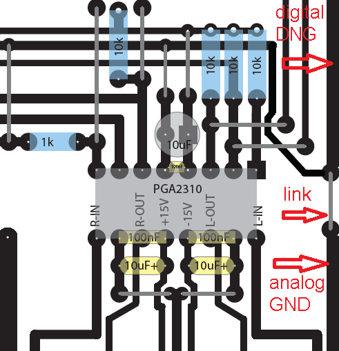

    i did my own PCB, not professional printing, i etched my board, only one layer, so about the GND plane that you think i have, i dont.
    but i can almost be sure that the clicks problems are not cause of the GND plane.
    you can see the part of the PGA2310 in the pic below, nothing under the PGA2310, the GND's are across the board.

  • Hello Isak,
    I have reviewed your schematic and do not see anything schematic related that may be causing your issue. As mentioned in my email to you, I recommend ordering a PGA2310EVM since not having a solid ground plane may be causing your issue.
    Can you verify, by probing the outputs of the PGA2310 with an oscilloscope (and be sure to DC couple the probes), that the gain is only switched after the output crosses zero twice? The PGA2310 datasheet mentions the zero point must be crossed twice or a time out of 16ms occurs for the gain to switch. If the zero point is not crossed twice, the gain will change 16ms later no matter what point the output is at. If the gain is changed after 16ms this may explain your issue.
