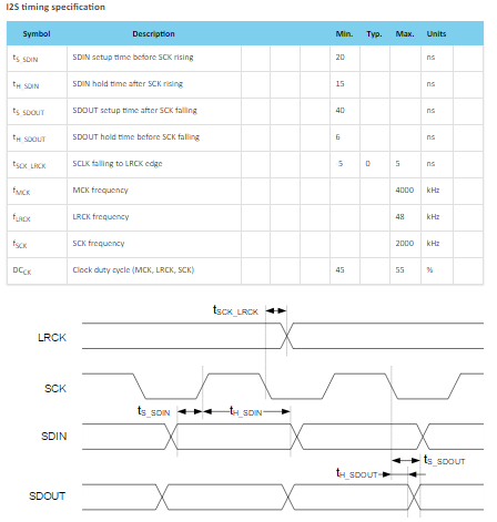

    About the I2S timing requirements, it is not possible for me to measure those parameters because my oscilloscope is not to precise. But I think the the ucontroller is featured to have and meet the I2S bus requirement, here is the electrical specification of the I2S bus on my ucontroller:

    Thanks for the patience, I know there has been a lot of back and forth on this. In the table you provided with the supported I2S frequencies, I see your uC can generate MCLK with 32, 64, and 256 multiple of Fs only.
    I also noticed that you said the max mclk supported by your device is 4MHz. However, it looks like all the 256*fs rows have higher than 4MHz clocks (perhaps with the exception of fs = 16000Hz in which the error puts you right at 4MHz). Are you unable to generate the lrclk = 32kHz, mclk = 8 MHz and lrclk = 44.1kHz, mclk = 10.666 MHz rows in your table?
    The reason I ask is that our device does not support 32*fs for mclk or 16khz for lrclk. This leaves only 4 possible combinations from the ones you provided (two at 64*fs and 2 are 256*fs). I am still working with our design team on understanding the limitations of 64*fs for your application and will follow up with you on that. However, I am interested in whether you can test this with the 8MHz or 10.666MHz settings (the two settings that use 265*fs). I understand this may not work since you did mention you couldn't go above 4MHz. If so are there any other settings you can use with your uC to get lrclk in a supported range for the TAS5760 (32,44.1,48, etc) and an mclk multiple of 128, 192, or 256 times lrclk?

    Yes, I was able to generate all the clocks that were listed on the table, but the one with lrck=44.1 KHz (and MCLK = 10.667 MHz) is not within specification as it deviates -5.5 % (41667,67 Hz) from the actual sample rate.
    For the supported MCLK rates it was just that the specifications listed on the I2S timing table were tested using MCLK's up to 4 MHz. I have used many variations of the clocks for testing, some with even 512*LRCK(512*31250) as MCLK. Below I post a picture with clocks I have used to test (marked yellow).
