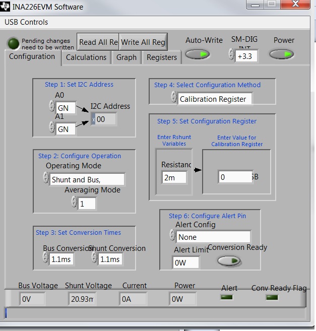

  • After several try. The probleme should come form the driver I'am currently using.
    But In the other hand I want to try what you ask me :
    "Pullup resistors R3/R4 should be 10k ohms"
    On the datasheet, the bill of Material indicate 300 ohms for R3/R4. Do I have to change it ?
    Here is the screenshot of the measure taken with the configuration show above.
    As you can see the Conv ready Flag stay off. Even if I press the Read All Reg button several times. If I do it on conversion mode the Conv Ready Flag goes on.
    Let me know if you have any idea, I'am still looking for the driver.
    Regards.

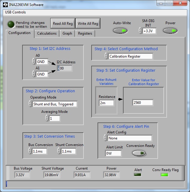

  • Hi Florian,
    What driver are you currently using?
    The BOM is incorrect R3,4 should be 10k ohms (I measured the EVM to make sure).  Can you measure them?
    Can you setup you configuration identical to mine?  I see that the calibration register is blank (it should be set to 2560).  Also, trigger off of both Shunt and Bus.  Tie the Vbus pin to Vs on the board and tie VIN- to GND.
    If this isn't working, I think a phone call would be a good, so we can walk through the setup together.  Let me know when you are available and we can coordinate a phone meeting.
