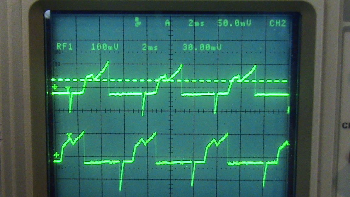

    Top reference 5200 RPM motor - lower reference motor below 100 RPM:

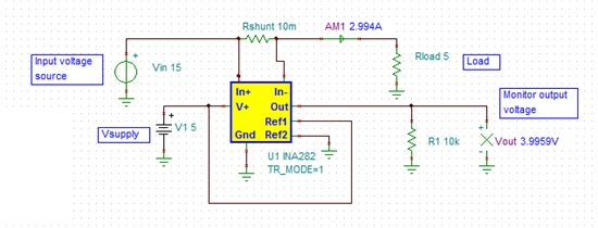

  • For other readers this post went to a land line conversation shortly after. The diagram on page 12 labels pin 1 to be (load) suggesting it face the FETS source with pin 8 labeled (-14 to 80v) connects to ground. Page 24 refers figure 43 page 25 explains summing H/L rail will avoid common mode transients.
    Some confusion here because we sense 3 low side shunts individually sum the readings in software then multiply & divide for an average RMS current. That is believed to have nearly the same effect as would adding more hardware versus using software to accomplish the same task.
    So in fact sensing the low side alone from a hardware perspective (page 24) is subject to CM transients.
    This case electron current flows from ground through the shunt back to B+ and any reverse current (hole flow) B+ to ground. Typically myself seldom use the conventional current flow theory unless the word (reverse) is noted somewhere in the data sheet. Those wondering what are (holes), recalling are depleted electrons returning home.
    Cutting pin 1 trace away from the three shunts did not stop the 15 amp fuse from blowing once again. However pin 8 was still connected and possibly the three IN282 will have to be removed.  To be clear all 6 FETS (DS) junctions free wheeling diodes measure very closely .516v drop. Driving a small BLDC motor the PWM signals appear on the oscilloscope very clean, no voltage level or edge anomalies on any phase can be found.
  • Have an possible answer for the blowing fuse. The IN282 may some how be changing the current flow upon switching on 169v B+. The 15 amp fuse rated 125VDC break point 300 amps worked with Opamps current sensing but not with INA282. The 10 amp fuses originally being used on the power PCB were rated 350VDC with a 56 amp break point but often popped well under a reported 9 amps set as maximum BLDC current. Having one last 10 amp SMT fuse to install and it held for the INA282 switching on the 169v B+ but shortly blew upon running the larger BLDC motor.
    In hind sight the RDK power formula and Opamps sensing circuit seemingly could have been misreporting the actual current and wattage showing it to be far greater than what in reality was being produced or even required by the BLDC motor.
    Sunday installed an inline 10 amp 250v AGC fuse, arresting the very rapid fuse blowing symptom for goodness sake.
    The INA282 datasheet has no formula to help explain the amps/volt a particular shunt 18m ohms would produce on the output pin. The output center set at 1.488-1.490 volts, Ref1,V+2.975 shown above. The current is behaving very differently with INA282 and the BLDC under load seems to have more power fewer watts. The INA282 sense current appears move sine wave shaped than with Opamps. Less heat is now being dissipated by the BLDC doing the very same work as before.
    The running voltage across Rs (DVM) .480-.530mv DC or .050mv peak with a gain 50/(Ref1 +2.975) = 16.8?
    For the typical INA282 application with Vout=(1/2)*V+:
    REF2=V+
    REF1=GND
    Vo= (Isense*Rsense*50)+(1/2)*V+
    Isense=(Vo-(1/2)*V+)/(Rsense*50)  This is for current flowing from IN+ to IN-

  • Spent some time measuring the shunts drop again under load conditions both DVM and Oscilloscope.
    Really appreciate the INA282 ratio metric AC current sensing, appears more accurate than measuring a DC voltage rise fed into an ADC. The INA gain seemingly works out to be 16.8 or 50/V+2.975 being no input pre-bias exist on pin 1 and the internal difference amplifier bias is +2.975 renders roughly a .7%.error accuracy, not bad at all!
    Seemingly 7mv DC was being detected across the .018 ohm shunts rising to .029mv DC, .037mv AC by way of DVM. The oscilloscope across shunt shows a larger steady state amplitude, suspect  true RMS DVM to be *.707 peak. Hence the DVM is much easier to follow than a shunts complex analog signal displayed via an oscilloscope.
    Thanks again Jamieson :)
  • Estimating the INA282 sensitivity at 16.8 gain to be (.001109uv/amp) with a .018 ohm shunt. The ADC current formula and limiting code averages the INA output. The running motor current averages 1.6 AC amps cycle/cycle current limiting at shunt drop of .038ma (AC coupling). The motor current peaks near 3.2 amps.
    Motor current limiting is periodic and not the same as DC input current measured via DVM 4.1DC or 1.7AC amps.
    With a shunt of .005 ohms expecting the stator current limiting to be roughly 2.5 amps @ .012mv shunt drop. That stator current limiting average tends to double giving 5 amps AC peak current. Expect the supply linear current will also increase in similar manor but there is head room for much more average stator current.
    The net gain of the INA282 over using Opamp for low side current monitoring becomes suddenly visible in motor efficiency. The motor current seemingly is more AC periodic, the DC supply current SOA is 2x the motor current.
