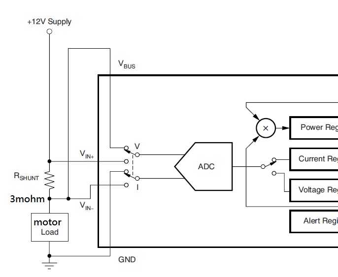

I use INA226 for sensing Motor current (15A max, 3mhom Rsh).
after connected Motor load by low side sensing, I found Ina226 blow up but Rshut resistor is still without damaged.
May I have your help and give me some suggestion? Thanks.

Hello Eason,
You described the application as low side sensing in your post, but the picture you attached shows a high side shunt. If your application is similar to Figure 23 in the INA226 datasheet then it is considered high side sensing.
We need more information to be able to assist. Can you provide a schematic of your circuit? Information about what the INA226 is connected to would be helpful.
I can see no reason why a load current of 15A through a 3mΩ would cause any issues for the INA226, so any damage to the chip may have come from your setup. Do you have any pictures of your setup?

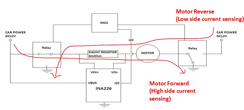

Hi, Kareem,
I am the system designer. Eason is our agent FAE. This system is installed in car to control electric window motors, INA226 is designed to sense current through motors to do electric windows prevent clamping.
The simplified system diagram is as below,
When motor starts working(current is about 2A), INA226 is working well. When motor stalls(current is about 12A), INA226 burns out.
Please advice why this system cannot work while motor stalls. Thanks in advance.

Dear Sir,
We have some problem need to be clarification in our application. In our Motor current sensing, we use both High side current sensing at Motor forward and Low side current sensing at Motor reverse. I learned INA226 is a Bi-Directional current sensor, is this workable for our application?
Moreover, When the motor starts working(current is about 2A), INA226 is working well. When the motor stalls(current is about 12A), INA226 burns out (we tried to measure the pin impedance of the fail unit , we found both VIN+/VIN- are damaged.
Do you think it will be damaged by over current? or over voltage spike?
Please kindly help on this issue and I am looking forward to having your comment , Thanks.
Hello Eason,
I believe the above is an acceptable application for the device. Your block diagram does not show anything that should cause issue for the INA226. 12A through a 3 mOhm shunt is within spec for what the device can survive by a large margin. Can you measure the maximum stall current?
Please look at TIDA-00302 for solutions for surge/transient protection.

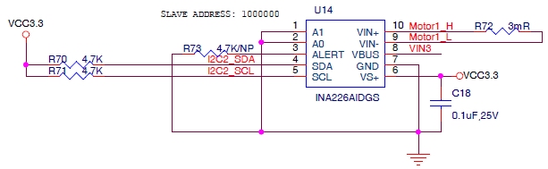

Could you provide the layout of your board? It may be insightful to see how power is being supplied to the part and how connections are being routed.
-Kareem Moulana
Eason,
Thank you for the information. There are a few points of concern with what I'm seeing.
Your shunt resistor's appearance is concerning. Is the resistor damaged or blown? To prevent your resistor from blowing, make sure to size its power rating with a healthy safety margin taking into account the maximum stall current. There appears to be bubbling/excess flux and solder on the shunt, which do not bode well. Solder and flux add resistance, which combined with a large stall current could cause an unexpectedly large differential voltage across your shunt resistor. Please measure what the effective shunt resistance is on the board.
During a stall current the power supply will sag, and when it is relieved the supply can rebound higher than its nominal value. Please attach scope shots of the common mode voltage as well as the power supply for the INA226 during normal conditions and during the stall event.
