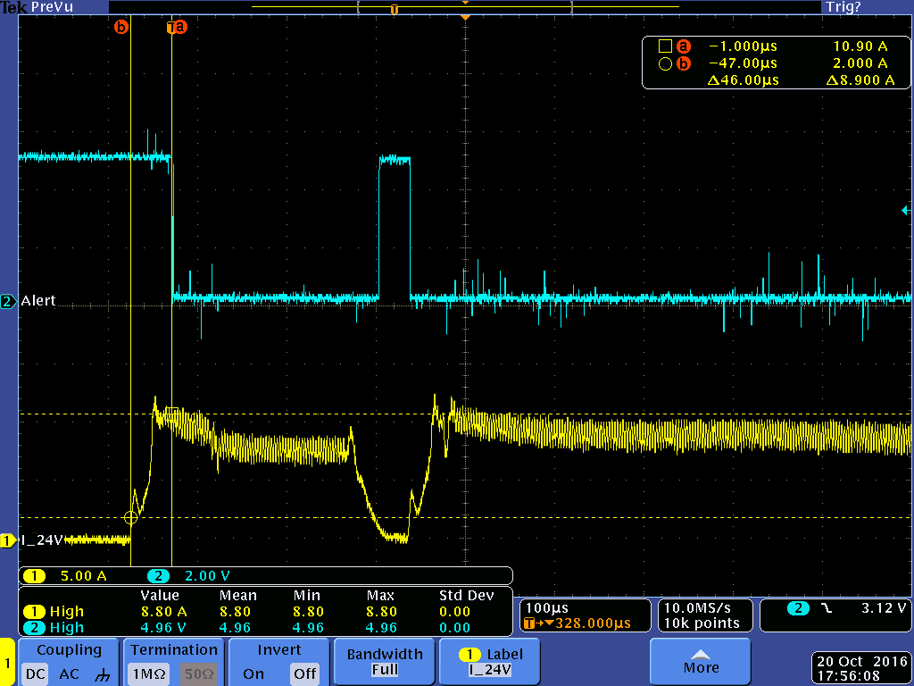

Hello Sirs,
Would you pls advise how to make faster response time on the INA301 EVM? We got ~50us delay time with 2A current limit, 12V Vcm and _5V Vs, while we found 1us (mx) specification on its datasheet?

    We used INA301A3 option (100V/V) with 1mOhm Rshunt -> I(limit) = 2A -> Vlimit = 2mV * 100 = 200mV -> R(limit) = 200mV / 80uA = 2.5kOhm

  • Hello Carolus, Thank you for your reply. We testd the INA301 with a hand held printer as the below bloack diagram...Wayne Chen
  • Dear Wayne,
    I was able to recreate your setup and have a look. Are you desigining in the worst cases for offset voltage and input overdrive? During my runthrough of your setup, I was able to recreate your problem when I attempted to bring my output directly to the point of the limit voltage. However, all parts come with a small Vos which will be amplified by the gain and be present on the output as well. You need to take this voltage into account with your limit voltage. Once I did this in the lab, the part's response time shifted into datasheet parameters.
    To visualize this, I would recommend applying a function generator to the inputs and sweeping through Vpp of a square wave to see what I am talking about. At the point of the trigger (Vlimit = Vout), you will see the limit pin pulled low, with the effects you're concerned about. Continue sweeping through a few more millivolts (15-20) and you should see what I am referring to on your scope. Let me know if this makes sense and if you need anything else.

  • Hello Carolus,
    Thank you for your elaborate. Delay time within a few micro seconds can still meet our customer's requirement. Will product line update the delay time specification or add application note in the INA301 datasheet to address the Vos impact?
