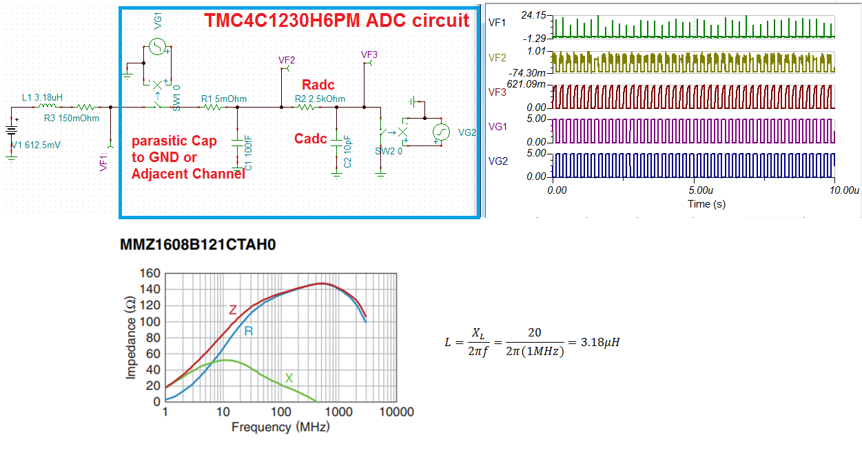

After making 75k series resistance output of A1 to SAR input a much larger transient occur to cause fault comparator trip. With 4R87k A1 output 1st transient pulse be just under comparator fault trip 2.7v. Below transient being far to large either way, A1 output has sudden gain explosion for no good reason we can easily pinpoint. The spike below would be 60 amps, no way has a 60 amp surge occurred!
Notice shunt signal lowers below ground yet A1 output seemingly moves in opposite direction, sometimes single 30mv pulse occurs. It seems the A1 must have much larger series R to stop sudden 1st transient. There is No 10k pull down on A1 output, seemingly may cause precision error % to increase? Otherwise wise 10k pull down on output would make path for ground noise to enter ADC channel.
Does the A1 output need much greater series resistance to stop current fold back effecting output? Does the A1 output specifically require a pull down R in order to normalize shunt inrush current from effecting the output gain magnitude in transient states?
  • A1 output 470k series resistor into SAR has even higher initial peak. Tina A1 model transient analysis produces plot with the inverse signal roll off of the bench model. Oddly AINx input (CH2) above should have 30ms rise time versus 5ms. Yet the A1 1st transient current pulse is greatly exaggerated immediately tripping fault comparator. This test seems to proves the A1 is directly causing unexpected comparator faults to occur.
  • Hello BP101,
    Although our TINA models are not perfect, I think there are additional details you are omitting in your simulation.  From what I know, you do not include the ADC on your output in your system simulation model.  The ADC is not a passive device. It has switching elements in it along with input resistance and capacitance.  This is further complicated by the fact that it is a multi-channel ADC. From my understanding of your system, you have a large inductor (ferrite bead) in front of the ADC, which is probably inducing some of the peaks you are seeing.  Below I illustrate the point with a circuit that I believe closely emulates the actual front end operation of the ADC.  Below I also calculate the inductance of your ferrite bead.
    Based off of this, I think you should remove your ferrite bead and remeasure the INA240 output.  I also would isolate the output for at least one measurement to verify there is not any other other unexplained transients occurring on the output of the INA240.
  • Hi Patrick,
    The ferrite bead MMZ102C (1k imped) clamps high frequency ringing + transient peaks as all ferrites do but only at certain frequency does the impedance increase. Actually stops a lot of PWM ringing other trash from entering ADC plus we add 3v3 TVS diodes before the ferrites. Those ferrites actually stopped false tripping of the comparator during run time but the bigger problem is the added running amplitude nearing 2.7v is not correct at all.
    Yet far off from what is occurring in the test bench captures posted above as a spike on the shunt is directly driving a transient peak amplitude near 2.7v on the A1 output. The bigger problem is the low level shunt noise, roughly 20mv  (9-16mv X10 probe) is not being filtered by the PWM rejection circuit and gets incorrectly added into the output as measured current.
    The only resolve is to improperly resistively divide the A1 output or add excessive input filtering. Such being done in other uses of the A1 TIDA engineers for noisy shunt conditions. That is counter intuitive to the datasheet explanation warning us to not add external filters on the input, the output should not require heavy filtering either. Yet in reality the datasheet fluff written PWM rejection transient suppression is a false narrative under low side monitoring!

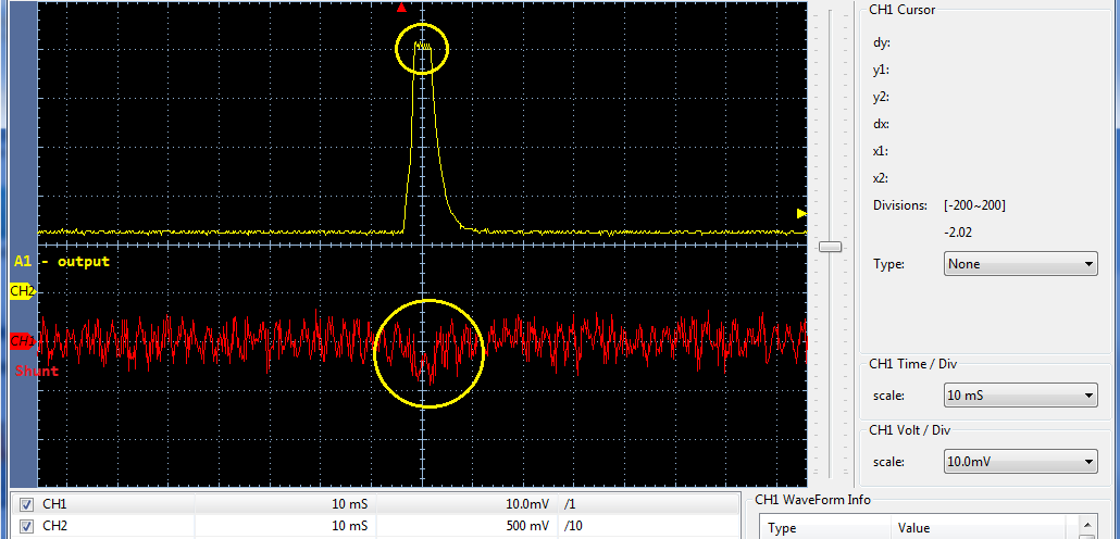

  • Seems we both missed capture signal shunt +/-IN (CH1) traverses downward yet the output shoots upward in opposite direction of CMMV pulses (yellow circle) relative to 1/2 REF (620mv). The shunt CH1 center peak in wave (yellow circle) often has single 30mv or more positive spike dead center. Again CH2 captured output behavior goes counter to Tina model +/-IN polarity of shunt.

    What your not seeing in captures is the comparator immediately cut off PWM drive after A1 output peaks above 2v7. First of all it should never be that high since the shunt idle CMV (8-20mv) drops downward as the inductive load is applied each cycle. The load always drops idle CMV of shunt when applied and should subtract from REF as negative inflection, not add idle CMV as a positive inflection to the solution.
    Indeed if we reverse Tina A1 +/-IN and add initial condition2 (+18mv) to -IN proper output drop 1st occurs and reduces the output solution by that drop amount. So the exact measure is then reduced by the low side idle CMV thus makes it seem the model +/-IN are backwards to the bench behavior. We use reverse computer analysis to simulate the bench condition, useful to determine real world events going wrong! In this case the load is pulsing current and the shunt has 130ms periods of idle recovery back to some point in between load and recovery cycles. TIDA-00909 uses continuous 3 phase sinusoidal PWM waves on each shunt, there is never 130ms idle load recovery time. With trapezoidal wave forms only 2 phases are active at any given time so the shunt recovers (floats).
    It seems the +/-IN pins are being reversed in phase from the PWM rejection filter as <50mv CMV (suddenly) drops. So far the only way to correct the output initial and ongoing CMV overshoot was to resistively divide output amplitude below 540mv. Setting REF to 320mv only produces a slight improvement greatly sacrificing precision. Also causes very large current spikes PWM duty cycles tripping secondary overcurrent faults. A no win scenario to mitigate condition by way of REF bias adjustments. Have to wonder if the A1 +/-IN pins polarity should be the same as  INA282 but that didn't seem to produce any ratiometric current ramps with A1 +IN to GND.
    The ideal A1 output shown below and that only occurs when PWM duty cycle is below 5%, with A1,A2,282. It seems they both get close in producing similar wave shape but is not very symmetrical even after testing various RC filtering into SAR.
