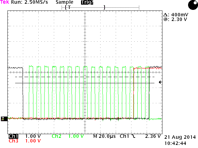

  • HI Edmond,
    I tried writing to the part on the bench and it looks like the LMP8358 does not like a pause between the two bytes.
    See the pictures below.  (Green is clock, red is data, black is CS.)
    The LMP8358 will correctly read the first transmission but will misread the second transmission.
    Please check that your waveform looks like the top picture.
