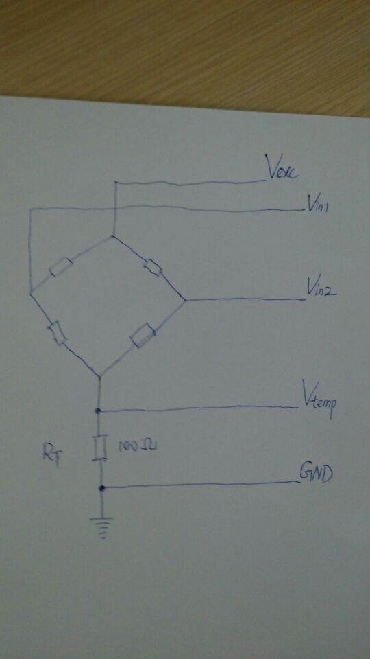

1 .  i use PGA309 evm to calibrate my bridge sensor.but now have one problems.that is the Vout is not reach my setting after calibration.my setting is Vout :max 4.5V,min 0.5.real Vout is  :max  4.2V,min 0.055V,i am confused,who know the reasion? the picture below is my calibration. Vout in red box

  • hello Williams,
    1.i use internal  power supply  4.096V.
       yes,the output voltage is not the same to my pre-cal setting.
       i use RT-  mode.  picture below is my connections
          this is my pre-cal file  :
    7457.v_4wire_p5_4p9.txt

  • Hello Yao,
    Your drawing of the bridge sensor connections is correct for Rt- mode. Your pre-cal file also looks correct.
    Are you using the sensor emulator for calibration, or your real bridge sensor connected to the PGA309EVM?
    Ian Williams
  • hi Williams,
    i redraw  a picture of my setting;  use real sensor.
     i use the sensor emulator for calibration with diode mode,the result is right.
    just only use real sensor for calibration ,the result is not right.for example:
    Output  voltage  my  pre-cal set is 0.5V-4.5V,but result is 0.055V-4.2V.I think the result of my calibration  should  be  same to pre-cal setting.
