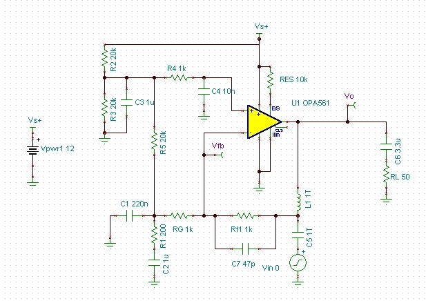

 We had prototyped the OPA561 as a simple inverting amplifier as attached. But It looks like OPA561 has an oscillation at -10 ℃ or less at our evaluation board. The oscillation began from -10℃ at 1.6MHz when it gradually lowered temperature from 25℃. And the oscillation frequency was moved to lower frequency when temperature further dropped to -40℃. Could you show us your evaluation results of the output spectrum of OPA561 at low temperature if possible ?

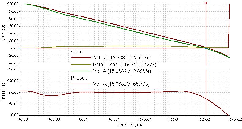

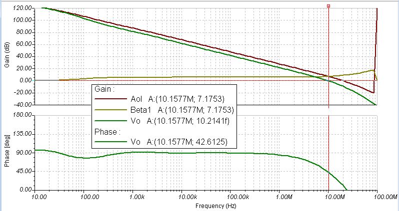

    Simulating the circuit you provided in your schematic shows roughly 45 degrees of phase margin.  While 45 degrees is generally considered a stable design, the temperature swing and output loading of this application may push the phase margin below 45 degrees in some cases.
    Let's try increasing the phase margin to roughly 60 degrees by placing a 47pF capacitor across the R16 feedback resistor.
    Here's a link to learn more about op amp stability:
    http://e2e.ti.com/support/amplifiers/precision_amplifiers/w/design_notes/2645.solving-op-amp-stability-issues.aspx
    I left all original components in this simulation, but I have a few questions about some of them.
    What are R18 and C35 for?
    What is R19 for?  I'm not sure that R19 is required, it doesn't appear toaffect the transfer function or dc operating point.
    Here's the results from the simulations:
    Original Circuit:
    Modified Circuit
    8713.Original_Open_Loop.TSC
    3581.Modified_Open_Loop.TSC

    • What are R18 and C35 for?
    R18&C35: it's 200Ω AC termination for the former stage amplifire.
    • What is R19 for?  I'm not sure that R19 is required, it doesn't appear to affect the transfer function or dc operating point.
    R19: it's for a bias of negative input port. It could be redundant.
