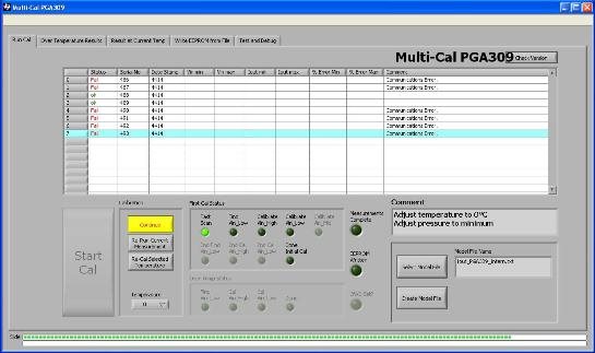

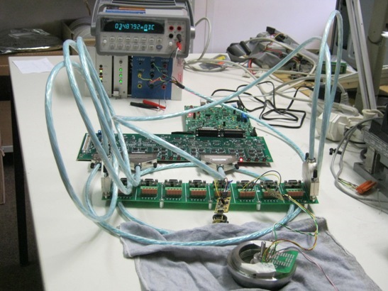

The test construction was as carried out as in the suitable user manual is described and is illustrated. We have in addition also from Texas suggested the Agilent 34401A multimeter connected by RS-232 (on COM1). We have done all settings for current loop mode like described in the user manual. By pressing the "Do Cal" button the automatic Scan performs perfectly. In the next step the system are trying to read the minimum value. On this occasion, an error is announced and the calibration is faulty.
This is our test setup with a real (5000 Ohm 1mV/V) presure sensor.
If we connect the PGA309 to EVM-Board, you see the parameter above. On minimum stimulation of the transducer
we get the offset of 4mA and if we stimulate the Transducer to maximum we get 20mA. This is o.k. ,but we don't get
this result by using multi-cal-system.
This is the first scan of PGA309-Module. This run is o.k. , because there are only two module connected to the system.
But during this step (the multi-cal-system perform a call to agilent multimeter to get the mA value) the wrong
values for "Iout min" are read by the software.
This are the results for channel 2 and 3 (the register setting is wrong)
This value for minimum and maximum are read directly by using Hyper Terminal programm.
This reading is correct, but not in the multi-cal-system !

    Second, can you please verify that you are connecting the +VDUT and -VDUT plugs of the power cable to a loop power supply which is floating relative to the ±12V supply? If not, then you will measure incorrect and high current values such as the 35mA in your photo.

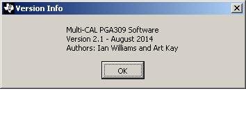

  • Dear Mr Williams,
    many thanks for the response and the new program version. I have uninstalled the old version
    and have installed the new one, however, the new version displayed the same version information
    as the old version.
    The results seem to be same as by the first program version.

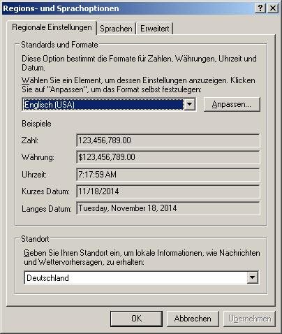

    Then I have set the language of the Windows-XP system from GERMAN to English-US language.
    The dot and the comma are exchanged there.
    At this moment the internal readings and calculations seem to be correct.
    This reading from the Agilent 34401A are correct. It is exactly the same value as on Agilent Display.

    The dot/comma error was definitely a problem - good catch by switching the language settings. We will need to consider that as a future software improvement.

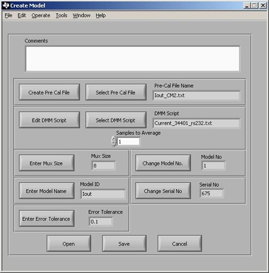

    No, I have taken over the available PreCal and model file from the previous program version.
    Here is the MODEL-File for our current mode application:
    The same file in text form:
    and here is the PreCal-file:
    the same file in text form:
    and this is the temperatue setting option:
    Many thanks for helping to solve the problem.
    Christian M.
