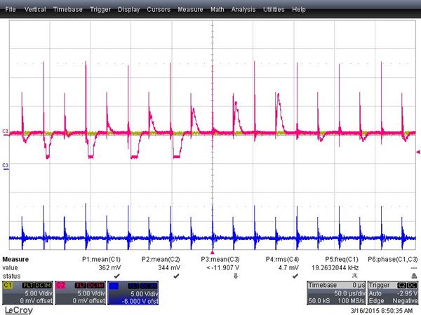

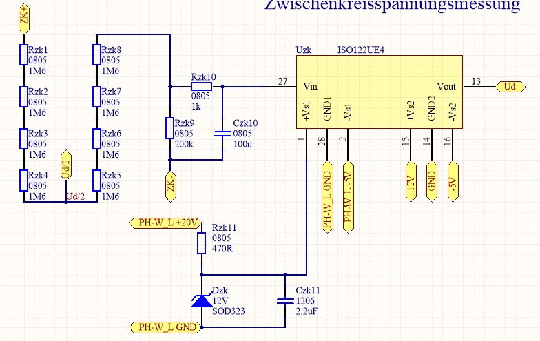

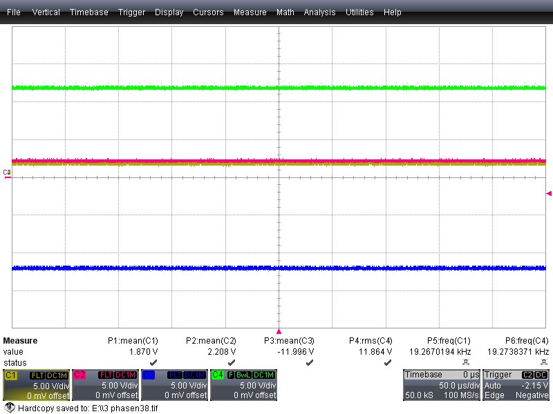

I am currently using an ISO122 in my three phase inverter.
The device is used to measure the DC link voltage and transmit a proportional analogue signal to galvanically isolated low voltage side of the inverter.
This is the schematic. A lowpass filter is located right after the voltage devider.
The blue voltage is the stabilized -3,3V (by Zener) supply voltage of the ISO122 (not in schematic included).
Yellow is the output of the voltage devider and red is the signal after the lowpass filter.

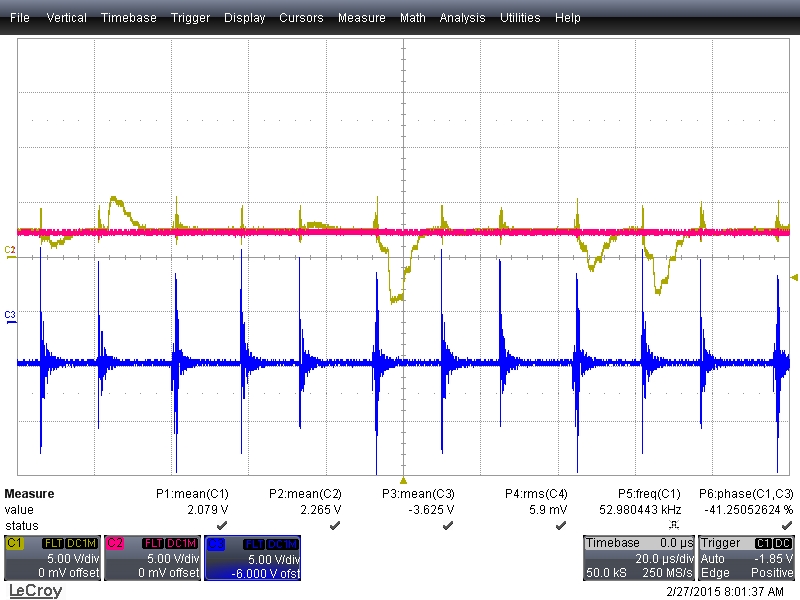

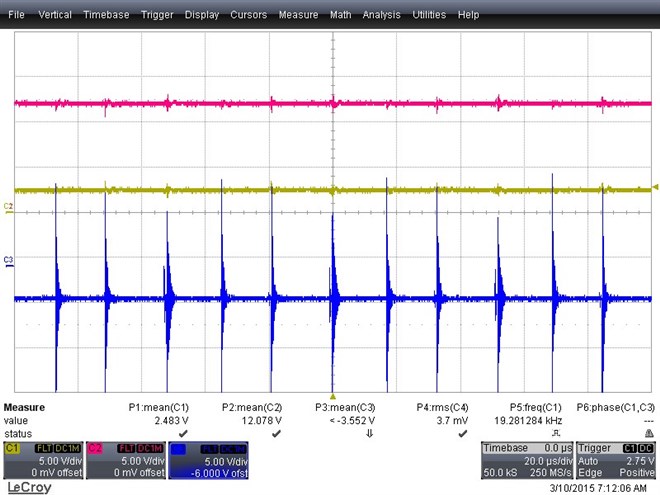

On the second picture blue is still the -3.3V supply and yellow is the output of the ISO122. (red can be ignored, as it is the heavily filtered yellow signal).
So my problem is why converts the ISO122 the red signal from picture 1 into this disturbed yellow signal of picture 2? I guess i have got some EMV issues but I am not sure where and which one. The Mosfets of the inverter are operated by 20kHz, so EMV is definitively a problem. If the PMW for pulsing the Mosfets is off, everything is fine.
Do you have any idea how I can improve the reliability of the ISO122 on my board? Do i have to add more capacitance at power supply? Or is the ISO122 simple not useable for my environment (20 kHz traction inverter)?

  • Hello Thomas,
    It seems that your PCB layout is very susceptible to the electromagnetic interference produced by the power MOSFET switching.
    I think the first issue to resolve is the excessive noise present in the negative supply of the ISO122. My recommendation would be to begin by incorporating more decoupling capacitance as close as possible to the GND1 and -VS1 pins of the ISO122. Moreover, it would be advantageous to also include several decoupling capacitors between + Vs1 and - Vs1.

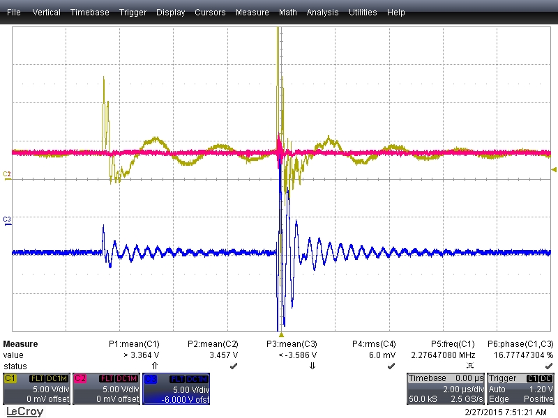

  • Hello Thomas,
    Do you know what was the effect of the added capacitance? Did it decrease the ripple in the -3.3 V supply to - Vs1? If so, by how much? could you post new oscilloscope captures for -+Vs1 and - Vs1 to see how stable those supplies are?
    Your first post shows almost 24 Vpp of ripple in the - Vs1 supply and such ripple is far too large for the ISO122 or any other precision component to operate properly. If the added capacitance diminished the ripple - Vs1 the it is likely that more capacitance will help. How much additional capacitance is needed depends on what the remaining ripple is.
    Jose

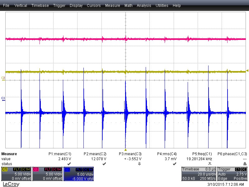

  • Hello Jose,
    thank you for your reply!
    Here are the new supply plots with the added capacitance:
    Yellow is still the primary (but filtered) signal, red +Vs1 and blue -Vs1.
    As you can see, the capacitance has nearly no effect.

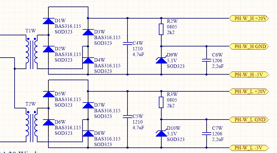

    I tryed a little further and connected the -Vs1 pin directly with GND1:
    The noise is still the same, though -Vs1 and GND1 are directly connected...
    I guess the problem is the fact, that my voltage supply for the ISO122 and for the MOSFET-Driver are the same...
    Here is a schematic how 19V (afterwards via Z diode to 12V) and -5V (afterwards via Z diode to -3.3V) are created:
    Hope you have now enough schematics (together with the ones above) and plots to get a good overview. If you need more data please do not hesitate to tell me. Thanks in advance!

  • Hello Thomas,
    Thank you very much for posting the new results. One point that I think I have not been able to convey clearly enough is that the measurements of the +Vs2 with respect to Gnd2, -Vs2 with respect to Gnd2, and Vout with respect to Gnd2 must be taken without making any connection whatsoever to the +Vs1/-Vs1/Gnd1/Vin side. In your image above you are showing Vin next to Vout. The problem with that measurement is the possibility of having introduced a ground loop with your oscilloscope.
    You will obtain incorrect results due to ground loops in either case:
    a) connecting the GND clip of of CH2 to Gnd2 and the GND clip of CH1 to GND1, or
    b) connecting all GND clips to Gnd2 and the tip of CH1 to GND1.
    The correct method is to only measure the In side signals in one case, and only measure the out signals in the other case so that the two ground planes of your board can move to the voltages they need to move and allow the capacitive barrier in the isolation amplifier to break the undesired ground loop.
    Since you indicated that the corrupted Vout signal is present even when the motor is not connected (but I assume your power devices are switching), it seems to me that the cables in your product/board are picking up noise and such noise is directly coupled into the output of the ISO122.
    My guess (and this is only a guess; I would need to see your product in order to have a better idea of what is going on) is that the cables you mention are picking up common mode noise at a give frequency range and such noise is being injected into the output of the ISO122. In order to troubleshoot the situation I would start by measuring the common-mode current present in the cables that you mentioned and displaying such common-mode current in a spectrum analyzer. With this you can identify the problematic frequencies the cables are picking up. based on that you can target the problem by:
    a) reducing the coupling between the EMI source (probably your switching power devices) and the cables
    b) shielding the cables in order to reduce EMI pick-up
    c) Changing the length of the cables so thar they are less efficient antennas for the switching frequencies you generate from the power devices
    d) filtering the noise picked up by the ISO122 output lines or by the cables (ferrites and capacitors are the typical options here.)
    The actual combination of solutions depend on the specific constraints you have in your system.
