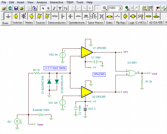

  • Hi Thomas,

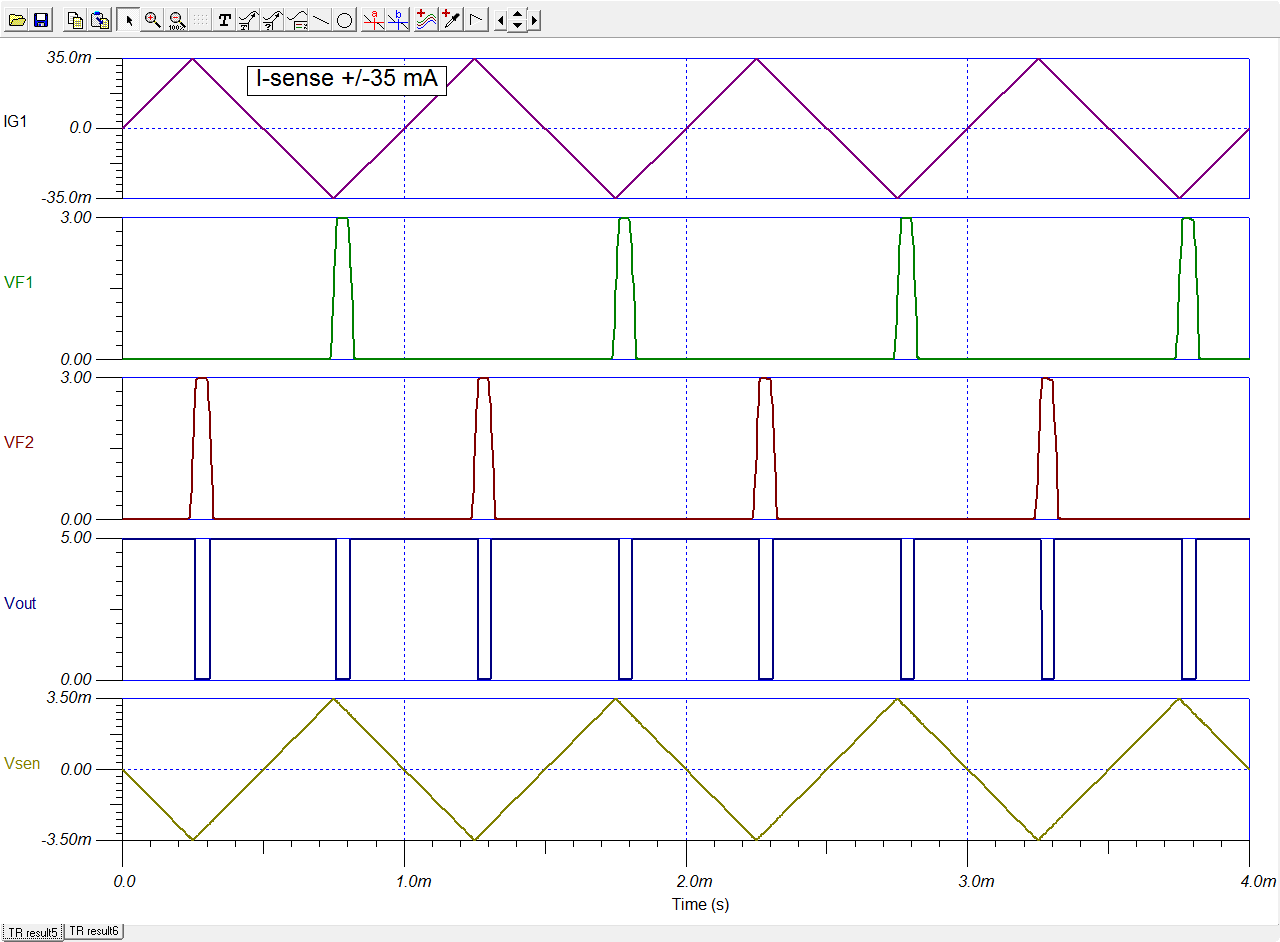

    Please see the current sense circuit below. A fast OPA2365 CMOS dual op amp is configured as a window comparator. The window comparator is followed by a CMOS NOR gate which results in the output going low when the comparison level is in-between the lower and upper reference levels. The reference levels were set to +3 mV and -3 mV so that when the current exceeded +30 mA and -30 mA the output state would change state. A NAND gate could be used if the output state needs to be the inverse.
    The output only changes state when the input is in-between the two reference levels so the dwell time can be short if the waveform has fast edges. The triangle wave used in the simulation has a slow rise/fall time and its dwell is longer with low current levels such as +/-35 mA, when compared to +/-3 Amps. The dwell could be very short for a square wave having fast edges.
    I have attached my TINA-TI Spice simulation circuit if you wish to run simulations.
    Regards, Thomas
    PA - Linear Applications Engineering
