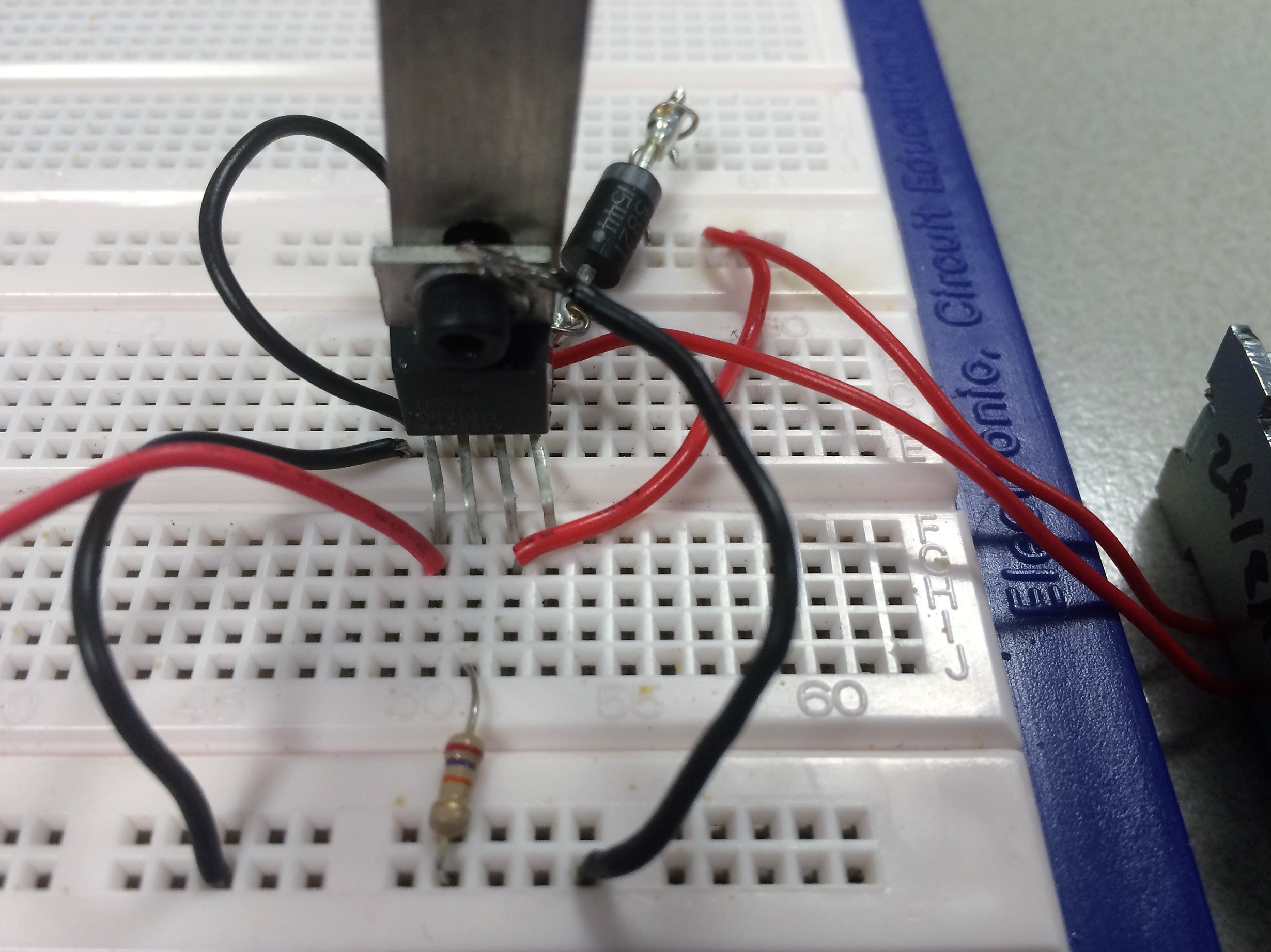

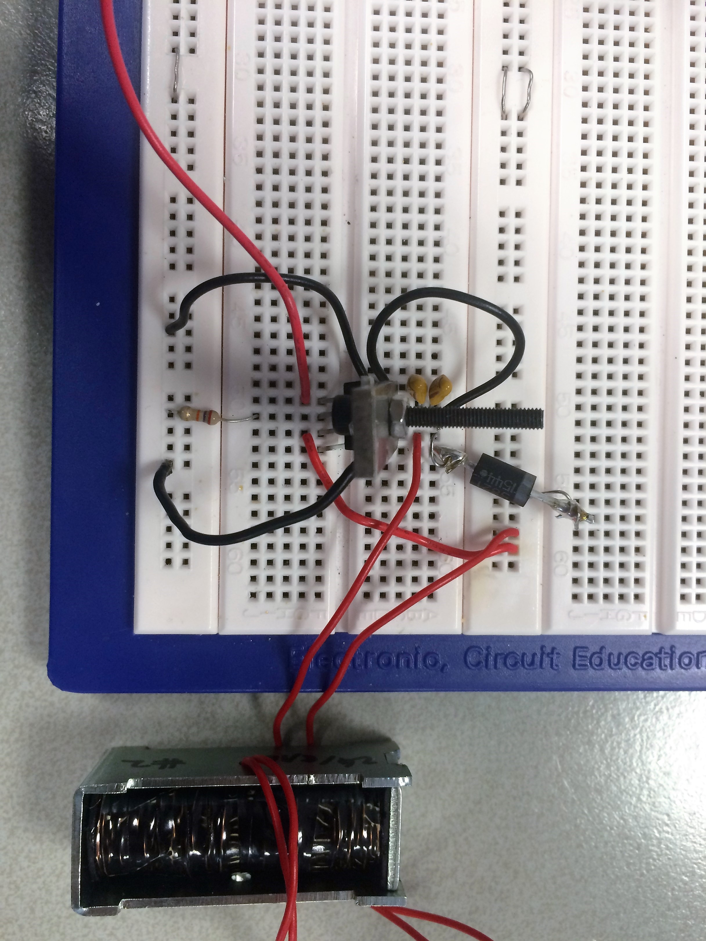

  • I have it on a breadboard. The circuit diagram and photos are below.
    The 5V is supplied direct from a 7805 voltage regulator.
    Breadboard diagram.pdf
  • If you had a fault condition, you would have its Flag output is driven low (pin voltage typically drops to 0.3V).
    According to your last screenshot, you have about 20mV in Pin 7.
    Before you had it high (normally working)
  • I see.
    When we use Breadboards, we could have some problems due to capacitance, resistance by faulty contacts, in high frequency would be worst, oscillations, and so.
    I would advise you to use a Perfboards, if you can do it, I think you can solve that problem in your circuit.
    If you have unconnected Pins, those could take randomly values, even more if you use a Breadboard.
    Please, let me know when you do something.

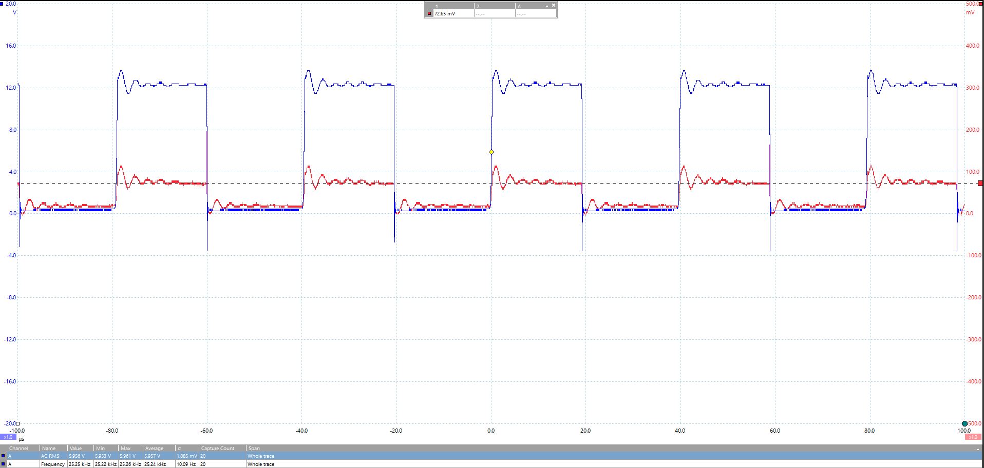

  • Having disconnected everything and completely reconnected it on the breadboard, I have had it switched on like this for the past hour and it seems to be working ok. A screen shot of pin 6 (blue) and pin 7 (red) are below. Do these look ok to you?
    It looks like it could have been the breadboard connections as you said. I'll solder one on to strip board to check.
    Also would you recommend putting a capacitor between Vcc and GND to clean up the output? If so, what type and value?

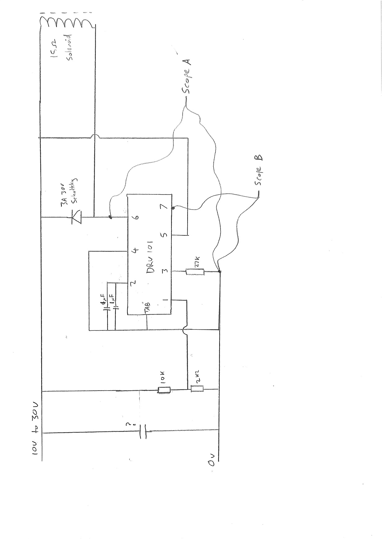

    On the final design I will not be able to use a voltage regulator to keep pin 1 at 5V. I was thinking of using a voltage divider using 10K and 2K2 resistors to give an output above 1.7V in the range Vcc = 10V to 30V. Do you think this would be suitable? A circuit diagram of this proposal is below.
