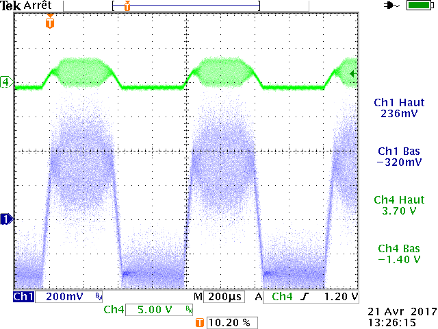

    I made some tests on the board with several load on the output in order to see the current's form,
    Here is the results (Voltage curve in Green, Current curve in Blue 1A=1V):
    At nominal current (20 Ohm) :
     With a 10 Ohm load:
    With a 5 Ohm load :
      With a 3.3 Ohm load:
    Positive current limitation is functioning well when the load is above 5 Ohm (around), but when the load is smaller, the ripple come again.
    I have done this test one more time with a new component (TO-220 package with dissipator instead of DDPAK mounted on copper area for test above) wired on separate board and I found the same behavior.
    I don't find in the datasheet any note about a minimal load for the current's limitation to work.
    Could  you confirm if the current's limitation can work on short-circuit (it's mandatory for my function)?
    Thomas Kuehl said:
    It is imperative that the thermal guidelines provided in the OPA547 datasheet be followed. If they aren't, it is very easy to get into situations where the thermal shutdown is activated unexpectedly.
    During the test, I checked the E/S pin and the voltage was stable at -11.4Vdc (thermal protection not activated).
    Arnaud

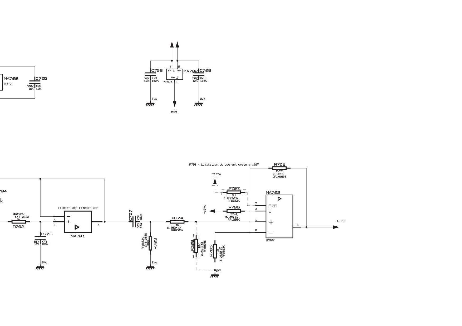

    So it appears that the noise/oscillation is observed on the output current waveform, both on the negative and positive portions? I do find it curious that the noise/oscillation doesn't appear on the voltage waveforms until the load resistance is down at 3.5 Ohms. It would seem that it would appear on both. What instrument are using to measure the output current, or are you using a current sense resistor?
    Would it be possible for you to share your schematic. I don't suspect that there is an issue with the way your are applying the OPA547, but I want to make sure there isn't something that hasn't been overlooked.

  • Hello, Thomas,
    No, the noise you see on the blue curve, is mostly due to my current probe which is not dimensioned for that range of current (it's a 30A current probe) and my scope don't allow me to filter that noise.
    That's why we have this difference between the green and the blue curve.
    The green curve is most representative of the output's behavior.
    Here's an extract of my scheme:
    C708 and C709 are 100nF capacitors
    R708 was updated to 21k Ohm
    Arnaud
  • Hello Arnaud,
    Each of the two OPA547 output current limit circuits have local feedback loops. I suspect the positive current limit circuit is becoming unstable  the OPA547 output exhibits the oscillation on the positive peak with the 3.3-Ohm load. There are two things you might tray if the oscillation during certain load conditions is an issue:
    1. Try bypassing Pin 3, the current limit resistor connect pin with a 10 nF capacitor to ground.
    2. Add a series RC snubber from the OPA547 output to ground. Something on the order of 3.3-Ohms and a 10 nF in series. It should be connected right from the output pin to the ground plane close to the output pin.
    Please let me know if either of these make any difference.
