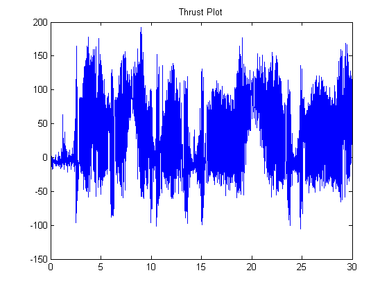

Hi to all!
I have a problem to acquire the output signal from the INA125P. My circuit is like to this (from forum.43oh.com/.../):
the only difference is that i have added a 0.1uF capacitor between S+ and S-. This work fine if I use it for the normal weighting operation, but work bad if i need to measure a thrust from a bldc motor with propeller.
In particular during an acquisition session i obtain this signal from adc:
this is very noisy and unuseful signal because this signal have much negative values, so i can't use it for my purpose.
However i have tryed to insert a RC filter and i obtained some improvement:
I obtained this signal using the original circuit above ( without the 0.1uF capacitor between S+ and S- ) and a RC circuit whit R = 4.7KOhm and C = 4.7uF. I have used this value because with other values i obtain however some negative values. However this signal is less usefull because i can't measure the full thrust generated of my motor and propeller. I understand that this is due from the RC filter that isn't fast, but i not know how to improve this signal using a different value of R and C without have a negative value.
My question is, how i can improve the circuit to obtain a better and usable signal for my purpose? I'm not an electrical engineering, so i have some problem to find a solution.
  • Hi Luca,
    The small INA125 circuit is not legible and we are unable to make out the circuit details. I realize it wasn't legible on the website, but could you please provide a more view-able circuit diagram? We need to see the details.
    Please provide information about the motor that drives the propeller. Is it a PWM or another type of motor? How physically close is the motor to the sensor bridge? What precautions were taken to assure that the INA125 circuit doesn't have noise from the motor and surroundings induced into it?
    What does the INA125 output look like when the motor is turned off?
    Can you provide a photo of your measurement setup?
    Regards, Thomas
    Precision Amplifiers Applications Engineering

  • Hi Luca,
    Thank you for all the additional information about your INA125 application. I have reviewed your circuit design and have concerns about the implementation:
    • The INA125 is set for a gain of 4000 V/V; that is a very, very high gain. Not only will the differential voltage from the bridge be amplified by this gain, but all noise picked up by the interconnect wires and circuitry. The photos that you ave provided show tremendous amplification of noise riding on input bridge voltages. Circuits operating with such high gain must be enclosed in metal enclosures and connections to the bridge must use shielded cables.
    • The INA125 is only powered by a single, +3.3 V supply in your circuit. That much limits the voltage range that can be applied to the VIN+ and VIN- pins. There isn't a datasheet plot for the input common-mode voltage (VCM) range for a single +3.3 V supply, but the INPUT COMMON-MODE VOLTAGE vs OUTPUT VOLTAGE, VS = ±5V plot on Pg 5, shows the VCM range for a single + 5 V supply. That plot indicates that the minimum VCM is about +0.75 V, and in your circuit the voltage at the VIN+ and VIN- inputs is about +0.625 V because the bridge bias voltage is only +1.25 V (pin 13). This assumes all 4 resistors in the bridge are equal value. Very likely, you are attempting to operate the INA125 below its minimum VCM capability.
    • The very high 4000 V/V gain also amplifies the voltage offset (Vos) of the INA125. The specified input referred Vos is +/-75 uV typical, +/-500 uV maximum, with a +5 V supply and at room temperature. It might actually be higher with a +3.3 V supply. If you multiply to typical and maximum input Vos levels by 4000 V/V, the output referred voltage offset Voso would be +/-0.3 V and +/2 V, respectively. This Voso will add, or subtract from the expected output voltage resulting from the bridge operation. Keep in mind that the INA125 output with Vs = +5 V is limited to (V+) - 1.2 V on the high end, and (V-) + 0.3 V on the low end. Applying these limits to Vs = + 3.3 V at best the high level output swing limit will be about +2.1 V, and about +0.3 V on the low end, for an output voltage swing range of 1.7 Vpp. You can see that the amplified voltage-offset Voso is huge in comparison to the available output swing range.
    • In general, it appears that more consideration needs to be given to the way the INA125 is being applied.  I suspect that the negative noise spikes that drop below 0 V are due to fields being generated by the motor and is being coupled through the circuit. The INA125 operated from a single +3.3 V supply is not capable of driving its output below 0 V.
