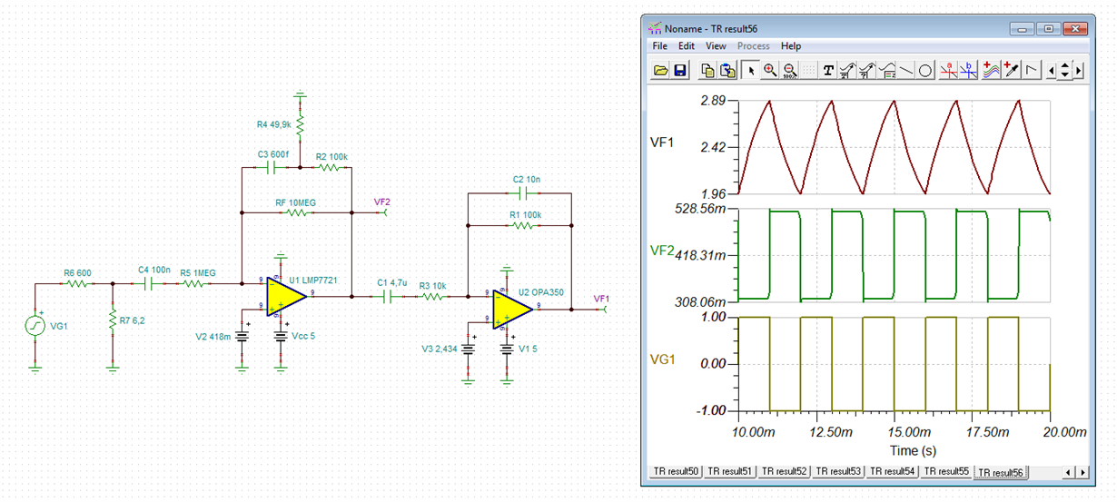

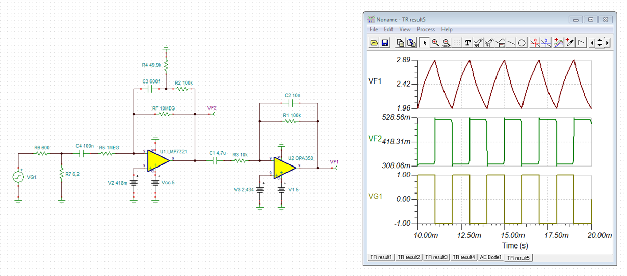

  • Hi May,
    I noticed that U2A and U4 are powered by different supplies. This can be dangerous for U4 during power-ups and power-downs or with the introduce of a testing scheme. I woud check the circuit whether U4 runs into latch-up when the output voltage of U2A exceeds the supply voltage of U4.
    If this issue is solved, I would use the following scheme:
    A simple 500Hz square wave is used. R6 stands for the 600R output impedance many signal generators provide. R6 and R7 form a voltage divider. C4 is important to absorb the DC voltage difference between the signal generator and the virtual ground of OPAmp, as Paul already discussed. R5 translates the testing voltage into a testing current. A phase stability analysis has shown that U1 (in my circuit) will work stable with R5 at its input.
    Again, keep in mind, that it needs about one second before the operating point of the circuit has stabilized. During this time period the output of U2 (in my circuit) will hang in the posistive rail and will emit about 5V. If your comparator has a latch-up problem, this can be an issue.
    may.TSC
    Kai

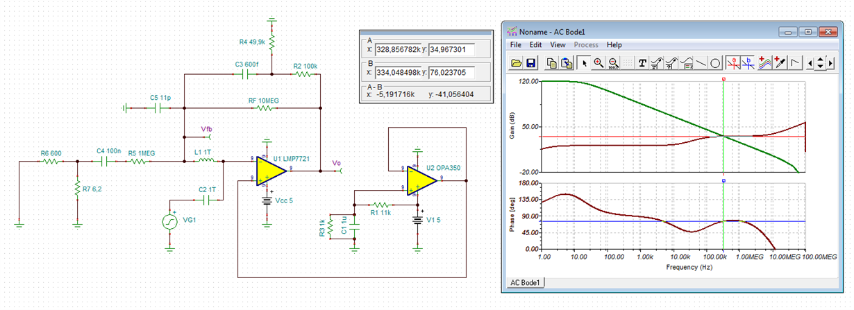

  • Hi May again,
    I forgot to add the phase stability analysis:
    may1.TSC
    Kai

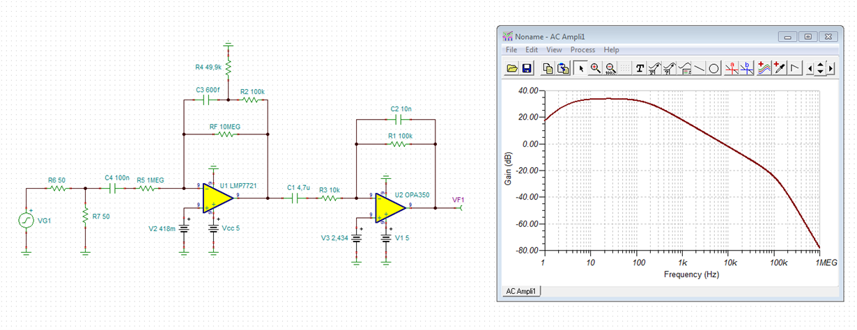

  • Hi May,
    the frequency repsonse of your circuit does not allow using a test signal with a frequency in the hundreds of kHz with a duty cycle of 1 or 2%:
    With such a test signal it's impossible to make the comparator toggle. That's why I have recommended using a square wave of 500Hz.
    Regarding the RC filter in the supply line: A 100R resistor makes only sense in combination with >=100µF. With a decoupling capacitance of only 1µF a resistor of 10...22R is better suited. Otherwise the impedance in the supply line could become too high.
