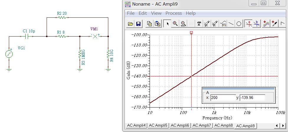

  • Hi Masa,
    assume your measuring object is contaminated with interference voltage, noise and transients and you don't want that noise being injected into the signal ground. That's the moment when you think about using an instrumentation amplifier like the INA129.
    The interference voltage of measuring object appears as common mode noise and reaches both inputs of INA129. In order to not erode the brilliant common mode rejection of INA129, you must take care that the biasing resistor connected to one leg of the thermocouple does not transform common mode noise into a differential noise. As the common mode rejection ratio of INA129 is about 125dB below 200Hz at a gain of 100, according to datasheet, you want a "common mode rejcetion" of your biasing resistor which is better than 125dB.
    The following simulation shows an application with a stray capacitance between the sensing point of thermocouple and measuring object of 10pF and a biasing resistor of 10k:
    You see that the common mode noise is suppressed by more than 140dB below 200Hz. So, this is a good scheme and the biasing resistor is chosen properly.

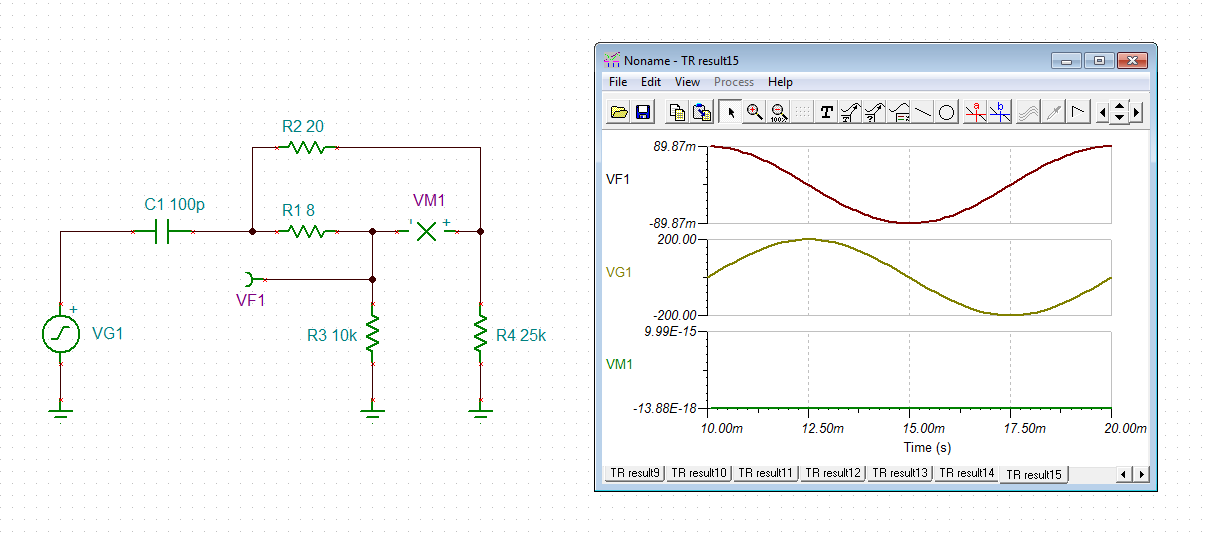

    But if the stray capacitance between the sensing point of thermocouple and the measuring object is higher, let's say 100pF, you will get the following simulation:
    The common mode suppresssion is only 120dB now and will degrade the performance of INA129. In such a case it might be useful to add a biasing resistor also to the other leg of thermocouple:
    Even if the impedance matching isn't perfect (22k instead of 25k), you will get a considerable boost in common mode suppression!

  • Hi Kai,
    Thank you very much for the thermocouple wire model and simulation.
    I simulated and got almost same CM suppression 139dB with R3 = 1M  instead of 10K.
    I wonder if the 10Kohm of return path resistance value is decided by another reason to discharge INA129 input charged voltage by bias current through C1, correct?
    INA129 bias current is very low then charge rate is quite fast that makes common voltage may drift well, then gained INA129 output will get impact the drift if R3 is not enough low to discharge the CMV drift.
    I would like to know how 10K is decided in the INA129 data sheet.

  • Hi Masa,
    the usual technique is to make the biasing resistor as small as possible and as big as necessary. Increasing the biasing resistor increases the absolute value of common mode noise the OPAmp has to withstand. So, it's not wise to increase the biasing resistor too much:
    In the following simulation the situation with a the stray capacitance of 100pF is shown:
