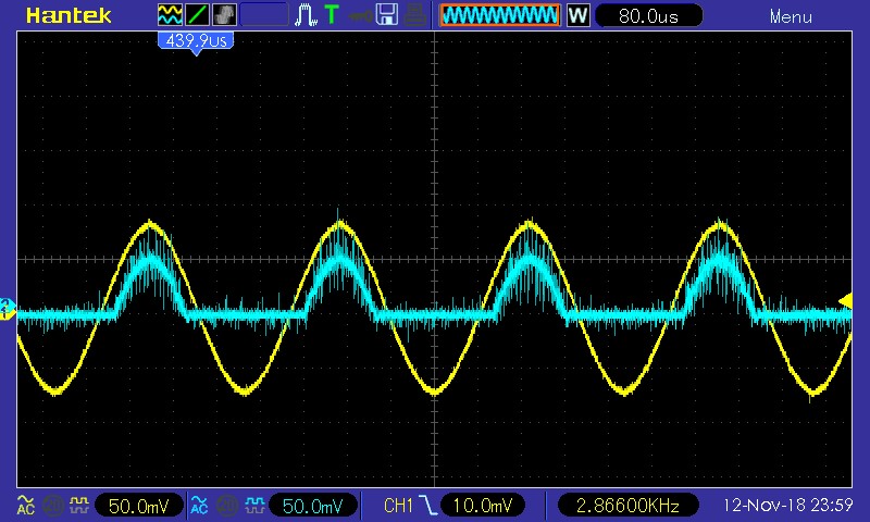

Q2) Can we remove the capacitors between the input and output of the THS4521?
We purchased the ADS1274EVM-PDK, which has THS4521 circuits on-board. On the board, it uses 1.5nF capacitors in parallel with 1KOhm feedback resistors on the THS4521 (see image below).
These capacitors form a low pass filter with a cutoff of 103kHz on the output which is undesirable for us.I removed them manually from the board. However this resulted in the signal shown below.
Yellow = input, blue = output.
The input was single ended from a 600Ohm source. When the capacitor is present, the FDA works fine, when it is not present, we see the signal in blue above. Is there a reason for this behavior, are these capacitors necessary for stable function?

    2. The capacitor is not necessary here for stability, since the FDA is in a gain of 0dB (it is internally 2 single ended amps in a gain of -1/+2) . It might be helpful for noise filtering. Are you familiar with the subject of op amp stability? Sometimes a feedback capacitor is needed to prevent the parasitic input capacitance impedance from making the internal single ended gain =0dB over frequency, since they are typically minimum gain of 2 stable.

    2. Yes I’m familiar with that concept, but I can’t say I’ve seen the behaviour shown when a capacitor isn’t present between the input and output of an amp (oscillations yes, but this looks like rectification!). What are your thoughts on that?

  • 2. This amplifier is technically unstable, but the capacitor filters out the resonant frequency. You can stabilize it and therefore eliminate the capacitor if you put a 1pF capacitor directly parallel to the two feedback resistors for 100MHz of bandwidth.
