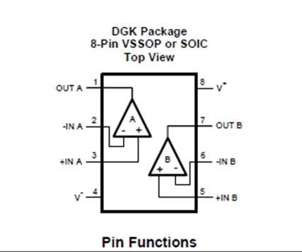

LM7322: P/N: LM7322MAX/NOPB conspicuous resistance values measured on some parts between pin1-4
Part Number: LM7322
**** SO# 446657 ****
our customer mentioned tat they have 8pcs failed of 2500 purchased during the ICT test.
Between pin 1 and pin 4, a resistance of approx. 30 - 200kΩ is measured.
The "good" components show a resistance of >= 10MΩ. These components were soldered.
- For a piece that has not yet been soldered, the resistance between pin 7 and pin 4 is about 100kΩ. The resistance between pin 1 and pin 4 is >= 10MΩ.
But there are no failures during functional tests.

  • Hi Adnan,
    pin 1, pin 4, pin 7 of what?
    You should show us a schematic...
    Kai
  • My apologies Kai, I forgot to add the schematic of the part showing the pinout:
  • Hi Adnan,

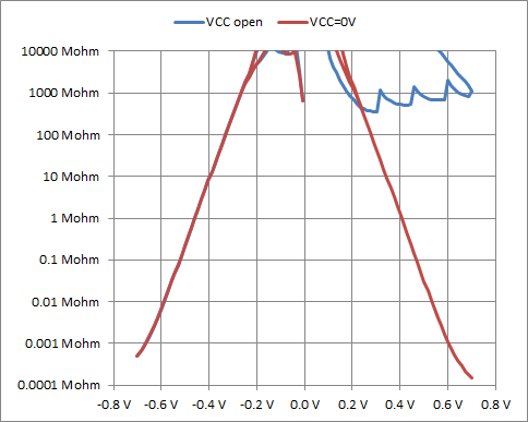

  • Adnan,
    Device pins have non linear characteristics. Too much voltage could actually power on the part.
    What is the voltage (and current) for these ICT resistance tests?
  • Adnan,
    Here is data I just recorded for pin 1 to pin 4 with pin 8 open or 0V.
    Pin 1 Current vs. Voltage
    Pin 1 Effective resistance V/I vs. Voltage
  • Hi Ron,
    The voltage for the ICT test is 0.3V.
    The resistor R135 (20k) should be measured. However, the "resistance" from the position IC22 Pin 1 to Pin 4 is apparently also measured, because the resistors R144 and R152 are very low to ground.
    Require confirmation that the internal resistance of the operational amplifier can be undefined.

  • Adnan,
    I can see the schematic picture now. The typical "resistance" at 0.3V per my chart is about 30M ohms, therefore the measurement in circuit should be 20.05k ohms.
    However, the output transistor is large and has high gain. With power off there is no active turn off for this transistor. Therefore there is some normal current flow. My sample was less than 1nA.
    For your 30k measurement, was that also at 0.3V? If so then current was 10uA which is quite a bit higher.
    Can you run a simple test on your suspect units? With pin 4 ground, apply [0.1V, 0.3V, 0.5V, 0.7V] to the suspect output pin and measure the current values.
    If the data has the same shape as my chart, then the current is normal transistor current.
