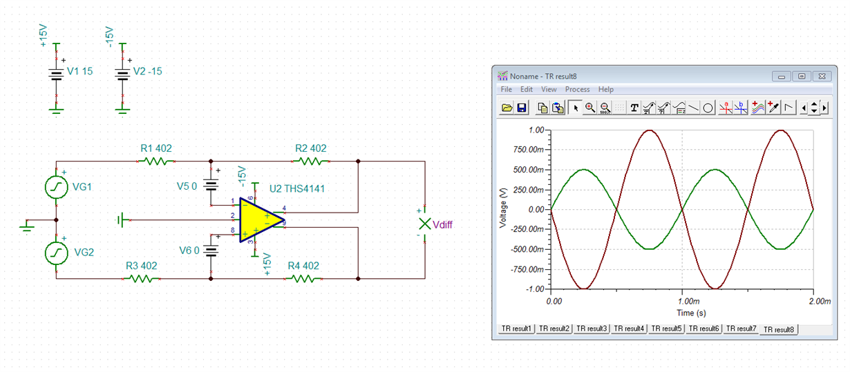

While simulating with TINA circuit with THS4140 for gain = 10, we see that result is not as expected and furthermore, the values of the positive and negative terminals not symmetric.
Rf and Rg are as recommended by datasheet.
As shown in diagram, for the 1V input, the gain is 9.97 instead of 10, and output differential terminals are 50 and 20 mV off (and not symmetrical).
Assumption was that we should be able to see gain = 10, as per recommendations, and symmetrical differential output, in the simulation.
Is the problem in the simulation environment or does it reflect "accurate" device behavior? (can we rely on simulation results in this case?)
Arie
  • Hi Arie,
    this is the result of input bias currents, input offset current and input offset voltages of THS4140. Have a look into the electrical characteristics of datasheet.
    Kai

  • Hello Arie,
    In the previous E2E post found here: e2e.ti.com/.../768383
    You were not measuring between the inputs of the amplifier but rather between two nodes directly connected to GND. This will reflect 0V in any case. The voltage meter should be connected between the inverting and non-inverting pins of the amplifier to reflect non-ideal effects of the model.
    Also what voltages are you trying to input into the device using VG? Are you trying to input a differential signal of 1V (+500mV and -500mV) or are you trying to provide a DC signal of 1V for both inputs (differential signal of 0V)? The way you provide an input in your schematic does not reflect either case. Putting a voltage source between both nodes only guarantees a differential voltage of 1V but does not guarantee a specific value for either node.
    Hasan Babiker
    In our circuit, there is differential signal feeding the amplifier; this signal range between -1V and +1V, so after the amplifying stage with gain=10 we get output signal between  -10V and +10V.
    My question here was regarding the expected amplified result in simulation, for +1V at amplifier input, because the result we get in the simulation is different than expected ==> should be +10V, 5V on each terminal and we get 9.97V, and the non-symmetric values for positive and negative signals.
    I understand from your comments that you recommend to feed the amplifier input with DC for each positive and negative terminal, as shown in the below
    Is this what you meant?
    If yes, note the result has remained unchanged (still 9.97V and the unsymmetrical values).
    Also, regarding your comment about feeding the differential source to the amplifier, it results in the value mentioned before, so the circuit seems to amplify the input signal, but not accurately ?
    Arie

  • Hi Arie,
    now I see your point. Yes, you are right, input bias currents, input offset current and input offset voltages should only shift the signal. But you obeserve a deviation of gain, right? I guess this is an issue of the model.
    Kai
    Yes, the gain is here the issue and I wanted to know if I can trust the model and simulation to reflect the parameters (I would hope it does) in which case the gain deviation is indeed reflecting the device. On the other hand, if the simulation with the device model doesn't reflect accurately the datasheet, then the interpretation of the gain deviation is different.
    For example if anybody can tell that this simulation and specific model were used and seen to reflect accurately the datasheet, that would help a lot.
    Arie

  • Hello Arie,
    There are a few factors that play into the error on the output. The input bias currents should only affect the common mode output of the device Vocm, and there is usually some type of offset on the Vocm pin that will contribute to the 33mV shift. You will also see that there is a slight difference between the two bias currents in the model which will contribute to Vdiff. Your concern of the gain, however, or the change of Vdiff is mostly caused by the differential offset voltage which should be somewhere between 1 to 7mV (from the datasheet) that will be gained by a noise gain of 11 V/V. Taking these factors into account, it is indeed possible to obtain this shift in gain in a real world application, especially with resistor tolerances coming into play.
    Hasan Babiker

  • Hi Hasan,
    if it actually was the result of differential input offset voltage, I would expect an output offset voltage shift, like shown in this example. But the output signal amplitude would stay unchanged:
    Arie1.TSC
    This is in contradiction to the result of Arie's simulation, which does not show an output offset voltage shift but a change of gain.
    Kai
    In regards to your comment Kai, the datasheet specifies two input offset voltage parameters. What I was referring to earlier was the differential offset between both inputs of the amplifier, or in the case of your simulation, a source of 51mV on one side and 49mV on the other to give an input offset voltage of 2mV.
    On your comment Arie, I agree that the gain error should not be increasing along with your input. As this is an older model, I would use it as a general reference but would not expect it to perfectly capture the function of the device.
    Hasan Babiker

  • Hello Arie,
    It makes sense that the gain would improve with respect to your input, since the offset voltage will contribute less to your total output. On the other hand, you mention that the offset is not fixed due to a fifth board giving dissimilar values as the first four. It is worth noting the possible range of the input offset voltage in the datasheet so there can be a variance in gains between boards. It is strange, however, that this specific board improves in gain when decreasing your input.
    Also to your previous question, yes I would recommend not relying on the model for this particular case.
