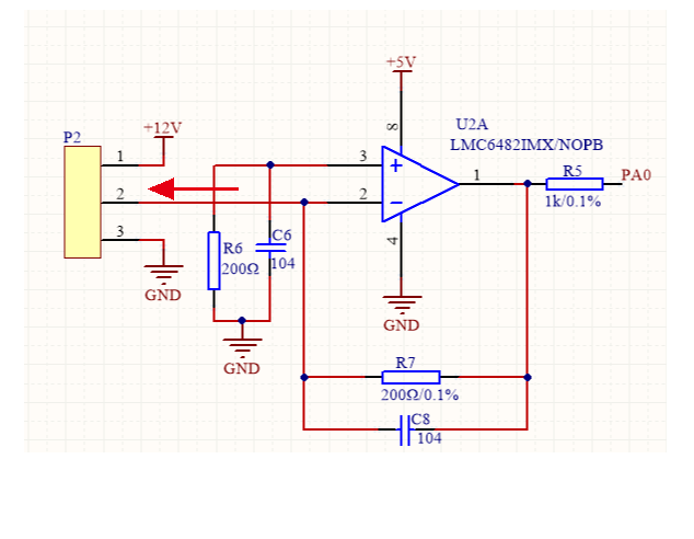

LMC6482 used for TIA? What is there different between OP and TIA?
and which is the direction of current flow? Into the shown circuit (from the left to the right)? Or out of the shown circuit (from the right to the left)?
The shown circuit will only work with a current flowing out of the shown circuit (from the right to the left)!
Can you show a schematic of your constant current source?
