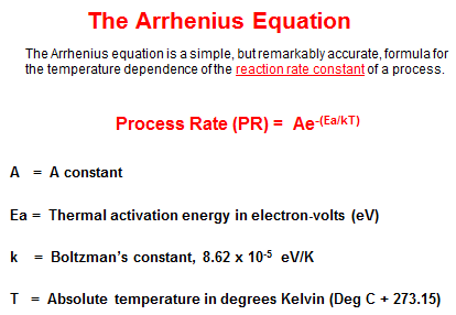

  • Hi Marcus,
    That is correct. OPA192 will automatically limit the output current to prevent damage to the output stage (Vout may be clamped) and if the power dissipation is high enough (P=Iout*Vs) to push the part into thermal shutdown, the output will become high impedance until the part has time to cool off.
    The minimum life of all of our industrial products, including OPA192, is specified as 10 years for non-stop operation at ambient temperature,Ta, but it gets shorter with an increase of the junction temperature in line with Arrhenius Equation – see below.
