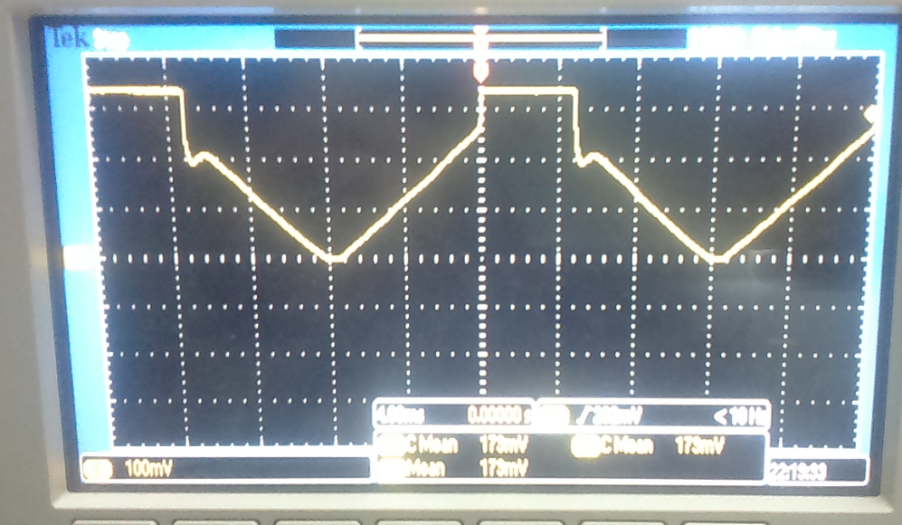

I experimented the above circuit giving a 50 Hz triangular wave with 3.3V peak to peak voltage and  1.65V of offset voltage. The out put is as follow:
I found that if I give the input a constant 2.6V the out put is as follow:
If i give lower than 2.6V or higher than it at the input, the oscillation removes. Means the above oscillation only exits in 2.6 V of input voltage.
Can you please explain me the probable causes of the strange behavior? And please give me the solution to the problem?

    I'm wondering, is the first shot of the output conforming with what we expect to see?  I ran a quick AC sweep in TINA and it looks like we'd expect a clean unity gain.  Also, I checked the circuit's stability and there is 55 degrees of phase margin.  So given this information, I'm not sure if the first output shot makes sense.  Is each mark in the scope shot 1V or 100mV?
    Also, is there any type of loading going on at the output?

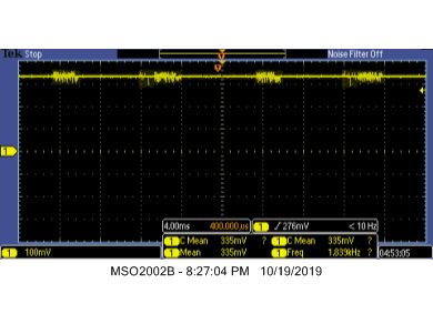

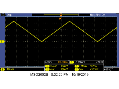

    Thank you for the replies and excuse me for the delay.
    Please see waveforms and ffts.
    - The supply voltage:
    - The supply fft:
    - Another supply fft:
    - input signal:
    The OPA344 is in a pcb. I provide each OPA344 with a separate low esr 10nF capacitor closed to the opamp.
  • Hi Ras,
    there's huge noise on the supply voltage! And the noise packets seem to occur synchroneously to the input signal when reaching the supply rails.
    You should use a much better source for the supply voltage (stiffer and less source impedance) and/or use a much bigger decoupling capacitance. I would recommend a 100µF electrolytic cap in parallel to 100...470nF/X7R for a test.
    Where do you have the 3.3V supply voltage from? Is there more circuitry on the PCB which runs with this 3.3V supply?
    Kai

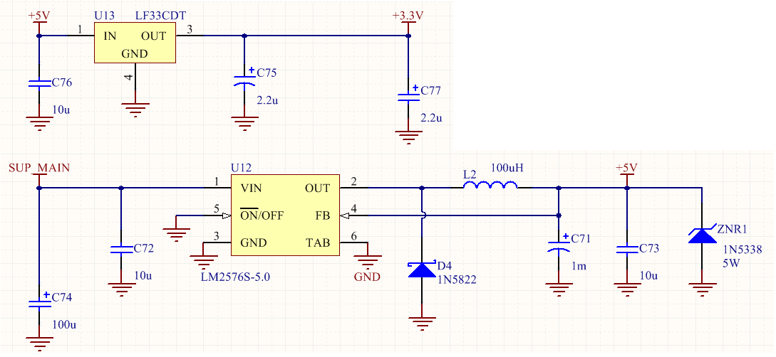

  • Hi Kai,
    Thank you for the reply.
    This is the supply circuit:
    Noise packets which are stable in the supply voltage travels through the input voltage and do not stand at the top o f the signal.
    There are other circuits; Some other opamps and a mcu. Although the digital circuit is not mixed in the analog circuit.
    Can we expect the OPA344 behaves similar to hysteresis comparator if the supply has such noise?
    I add some electrolytic capacitor but there is no any improvement.
  • Hi Ras,
    the supply voltage of an OPAmp must be stable, clean and noisefree. But for some reason your 3.3V supply voltage isn't clean at all! See how huge the noise is. Your input signal is even exceeding the supply voltage, when the noise makes the supply voltage fall down to 3V. This is not acceptable at all. You must improve the 3.3V supply voltage.
    I guess that the LM2576 generates a big switching ripple at the +5V output and that this ripple punches through the LF33 due to a poor input ripple rejection at higher frequencies. Figure 23 of datasheet of LM2576 shows how to add an optional output ripple filter. You should add this recommended post ripple filter.
    Alternatively, for a test, you could supply the LF33 with a different +5V supply voltage, which is free from ripple.
    Can you show scope plots from the +5V supply as well? I guess that we will see lots of ripple...

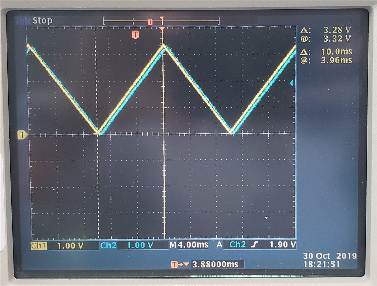

    Thank you for your patience.  I was able to run some tests on your circuit today.  I used the OPA344 in the configuration shown in your original image.  In other words, I did not place an output load to mimic the ADC input.  First, I put in a 50Hz triangle wave at 3.3Vpp with a 1.65V offset.  Everything looked normal as the output showed little to no attenuation and only slight phase delay.  This was as expected.
    Next, I input a DC voltage at 2.6V.  The output was a clean DC voltage with no strange oscillation.  Then, I moved the DC input voltage from 2.4V to 2.8V in increments of 20mV.  Still, I saw nothing strange at the output.
    Below are my scope shots.  Time divisions are 4ms/division and voltage divisions are 1V/division.  Both channel 1 and channel 2 have the same 0V offset.  Channel 1 in yellow is the input.  Channel 2 in blue is the output.
    It looks as though my setup is behaving as expected, while your setup is not.  Is it correct that you have tried running this test while disconnected from the ADC?  The only thing I can think of that might be different for our tests is that I have a separate power supply and no load.
    Please let me know your thoughts.
    Daniel
