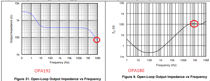

As far as I know, the ideal open-loop output impedance of an op amp should be as low as possible.
But I see the open-loop output impedance of opa192 is really high especially at low frequency. Nevertheless, the OPA180 has a low output impedance. Let us call the output impedance "Zo".
Question 1: Can you please tell me what type op amps have lower output impedance and what type have high output impedance? And what advantages can be brought if the Zo is high?
Question 2: In what situations is high Zo op amp more appropriate? And same question to low Zo op amp.
Question 3: I know the Zo can be reduced significantly by the loop gain of the op amp. What will be affect by these two parameter respectively? the open-loop Zo and closed-loop Zo?
Question 4: As for stability of amp, the isolated resistor is related to the open-loop Zo right? I found some equations like Riso = Ro * Rg/Rf. If the Ro is high like 1k , the Riso will be large. But the value of Riso is small in most examples, even in the application notes of the amp with high Zo.

  • First, you need to differentiate between the open-loop output resistance, Ro, and close-loop output resistance, Rout.  What you really care about from the stability point of view is Rout at frequency where curves of AOL and 1/beta (close-loop gain) intersect - this defines an effective bandwidth of the configuration.
    You cannot tell from the Zo graphs below what is the Zo below 1Hz for OPA180 (it does not show) but regardless, Zo, gets devided by loop-gain so for example dc OPA192 Zo of 3kohm for buffer configuration becomes only 3mohm (~3,000ohm/1e6).  Having said that for stability only value of Zout at the effective bandwidth is important and NOT its dc value. For a buffer configuration, Zo's are shown below in the red circles.
    Below please see my answers to your other questions:
    Question 1: Can you please tell me what type op amps have lower output impedance and what type have high output impedance? And what advantages can be brought if the Zo is high? Zo is inversely proportional to current in the output stage, thus the higher the IQ, the higher bandwidth and lower Zo.
    Question 2: In what situations is high Zo op amp more appropriate? And same question to low Zo op amp. Ideally, you would want Zo to be zero so it does not form a pole (and cause a phase shift) with the capacitive load - Zo of zero would allow an op amp to drive any capacitve load.
    Question 3: I know the Zo can be reduced significantly by the loop gain of the op amp. What will be affect by these two parameter respectively? The open-loop Zo and closed-loop Zo?  An open-loop output impedance, Zo, is defined by the IC designer so you as a user cannot change it.  Only a close-loop output impedance, Zout, is a function of the circuit configuration or loop gain: Zout=Zo/(1+AOL*beta), which you have control over.
    Question 4: As for stability of amp, the isolated resistor is related to the open-loop Zo right? I found some equations like Riso = Ro * Rg/Rf. If the Ro is high like 1k , the Riso will be large. But the value of Riso is small in most examples, even in the application notes of the amp with high Zo.  Adding Riso equal to Ro creates a zero (Riso||CL) and immediately cancels the pole created by (Ro+Riso)||CL and absolutely guarantees the stability of the system - see below.
    Riso of up to 10x smaller than Ro will cause a dip in the phase margin caused by the frequency separation between the pole and cancelling zero BUT it may be sufficient to guarantee stability of the system.  For more details, please see the link below:
