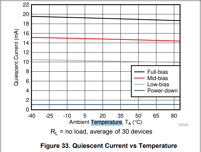

  • Hello Vinayak,
        That does seem reasonable. Below, I have attached a datasheet characterization of quiescent current vs temperature. It should still be around 20-30mA at those temperatures with no loading. So, even if your board is thermally heating up due to the mistake you brought up earlier, it should still be in that range. Did you try other THS6222s with the same outcome? If not, would you be able to try another THS6222? Also, I would suggest testing only the THS6222 in the same configuration as your schematic (input of 600MVpp and same gain) on another pcb board.
    Thank you,
    Sima
