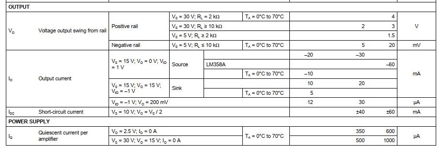

  • Hello Saurabh,
    Like Kai mentioned, this is due to output swing limitation. As you can see from the datasheet for a 5V supply, the negative rail can swing as close as 5mV (typical value) to the negative rail. One solution is to use a dual-supply, if you need the output to be 0V.

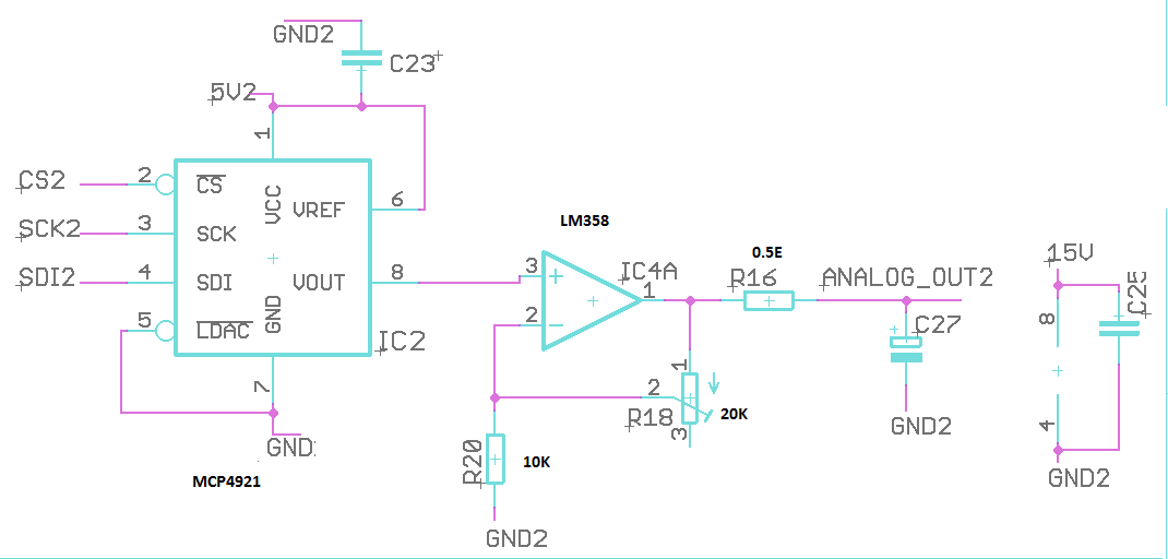

  • Hi Saurabh,
    it's not so much a question of input offset voltage but of output voltage swing. So, choosing an ultra low offset voltage OPAmp will hardly solve the issue.
    Can you show a schematic of your circuit?
    Kai
  • Hi Kai ,
    Following is the schematic with values and a DAC at its input.
  • Saurabh,
    Can you measure the voltage at op amp pins 1,2,3?  Where does "Analog_OUT2" go?  Does any current flow here?
