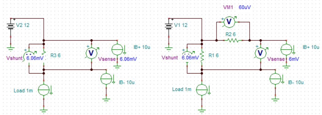

  • Hey Paulo,
    Unless there is some power dissipation requirement, there is no reason to use a 6-mΩ resistor for your application. You will want a 6-Ω shunt resistor to maximize the shunt voltage and minimize offset error. So with a 6-Ω shunt for currents ranging from 1 mA to 12 mA, the shunt/sense voltage will range from 6 mV to 72 mV.
    The INA226 (and all basically most other amplifiers) will exhibit the largest error at the minimum signal voltage. So the max error just due to offset alone is 100*10µV/6mV = 0.167%.
    The error tool online limits the shunt resistor to 100mΩ for no real reason, other than to limit IB error. We apologize for this if it has cause confusion.Now there will be additional offset errors from CMR, PSR, and IB. The IB won't be accounted for in the online calculator given the limitation of Rshunt.
    So if in your application the VCM=12V, then IB = 10uA going into each pin. If the device is measuring positive Vsense, then IB- will flow across the shunt resistor creating a voltage offset. So Vos_IB = 10µA*6Ω = 60µV. This is significant offset, but may not break any error requirements you have. Continuing along with the 6-Ω shunt example, this means the total max offset (Vos_max) equals 10µV+60µV = 70µV. This will increase error to 70uV/6mV = 1.167%.
    If this breaks the error requirement, you could either decrease the shunt resistor to reduce Vos_IB or you could add another 6-Ω resistor in series with the IN+ pin. This will create another offset in the opposite direction which should theoretically cancel out the Vos_IB error. See the simulation below:
    INA226example.TSC
    Peter
