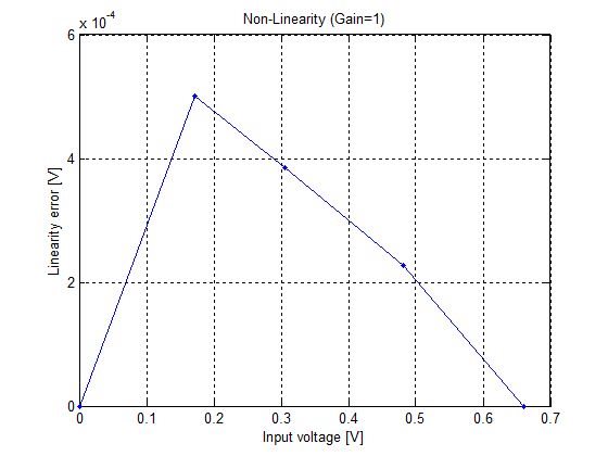

Picture 2 shows this for the first OPAMP stage with a gain of 1.

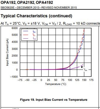

Picture 3 shows this for the first OPAMP stage with a gain of 0.06818
With a gain of 1 we see an max. error of approx. 0.0005V. With a gain of 0.06818 it is 0.0001V. With the original gain of 8.3333 the error is much higher.
This leads to the assumption that a higher gain has a higher max. error.

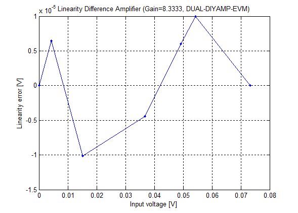

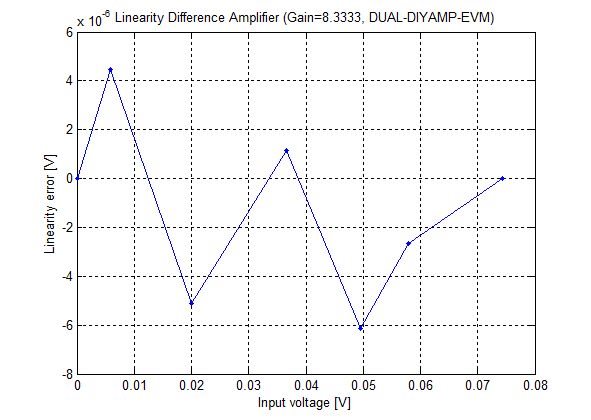

  • Thomas,
    I did some measurements on the DUAL-DIYAMP-EVM board. First with a gain of 1. Result: almost perfect linearity.
    Next I changed to a gain of 8.3333. I did two measurements. With the difficulty of stepping a 0...80mV input voltage I get also very acceptable results.
    Probably most of the error results from not beeing able to get the values from the multimeters (FLUKE 8845A) at exact the same time.
    Attached are the two results with the gain of 8.3333.
