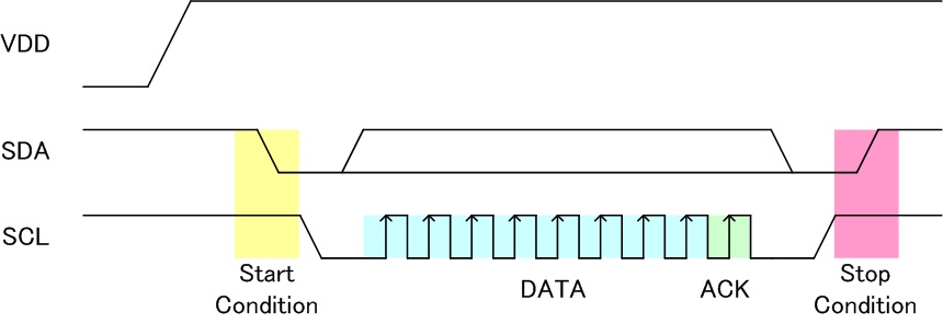

  • Randy-san,
    It seems I2C is positive edge triggered.
    I drew a picture of the I2C timing chart, so, could you please review whether it is correct ?
    Please tell us the correct sequence if it is wrong.
    Kawai
  • Kawai-san,
    I was looking thru the I2C specification and it does not specifically state if it must be positive edge or negative edge triggered. Rather, the SDA line transition must be stable during SCL logic high state (except for start and stop situations). If true, then it could vary from part to part.
    As for the diagram, it appears to be correct except for the start and stop conditions. Technically, the SCL line should be held high (with no transitions) while SDA transitions for the event ot occur. Your shading is showing that SCL is transistioning during these conditions.
    Cheers,
    Randy
  • Randy-san,
    Thank you for your great support.
    I have revised the I2C sequence, so I appreciate if you could review the attached file ?
    I'm asking the customer to test again following the attached file sequence.
    When sending 8cycle of SCL, I drew both the case of sending "00h" and "FFh". Your recommendation was "FFh" but the datasheet description says "00h". I am understanding that the data wouldn't matter because the object is to just clear the 8bits of the FIFO buffer.
    Is there any reason that you had chosen the data "FFh" (SDA=All High) instead of "00h" (SDA=All Low) ?
    Kawai
  • Kawai-san,
    As you state. it really does not matter if it is 0x00h or 0xFFh. The I2C bus specification states that the 0x00h is a general call address and 1111 1xxx is reserved for future purposes. As such, systems generally do not care about these addresses.
    As for the diagram, the Start and Stop conditions are now good. But, after looking at the bit sequence closer, technically the ACK state (SDA goes low or stays low) occurs after the 8th SCL bit. In your diagram, it shows going low after the 9th SCL bit. Now this is a a special "start-up" sequence and not the I2C standard bus specification. So as long as this is presented as the recommended "start-up" sequence, then I believe it is good.
