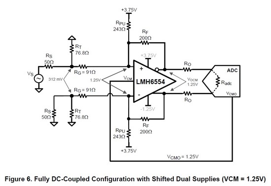

    2. Skewed Supplies: Use the FDA with skewed supply voltages (e.g. using a negative bias on the VEE of the FDA, such as +3.75V and -1.25V in the image below) to allow swings close to ground with minimal  or no impact on distortion.
    Here is an application note on this, where image below comes from:
    http://www.ti.com/lit/pdf/snoa565
    A method of generating a low negative bias is discussed here:
    http://e2e.ti.com/support/amplifiers/high_speed_amplifiers/f/10/p/170779/626965.aspx#626965

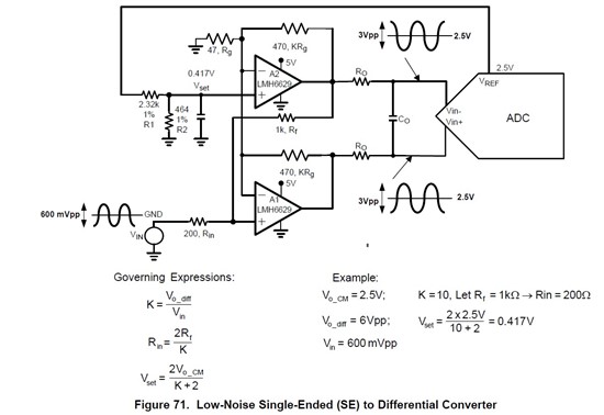

  • Hello again Niels,
    If the FDA's in the list do not serve your purpose, you may be able to do your own single ended to differential converter using discrete op amps (which you can optimize for power dissipation which seems to be your major concern).
    The LMH6629 datasheet shows one implementation (I'm sure there are other ways), for your review:
    Hooman
