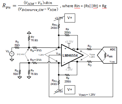

  • Hi Masaharu,
    Inorder to maintain the input common mode voltage (Vicm) at 1.9V, it would be required to use the Rpu resistor as shown in the http://www.ti.com/lit/an/snoa565a/snoa565a.pdf when using V+ = 4.4V and V- = -0.6V. However, make sure that the Vicm pin swing in single-ended configuration is within +/-1.2V from either supply rails.
    Also, what is the DC input voltage of the signal source? Please make sure to include the DC input voltage of the signal souce when using the equation for calculating the Rpu. I have included the equation below for calculation of Rpu when Vicm = Vocm.
    It should be possible to use the LMH6554 as a -6dB attenuator. However, LMH6554 being a current feedback amplifier, make sure to increase Rg instead of reducing Rf for stability purposes. A minimum of Rf = 200ohms is recommended.

  • Hi Masa,
    It seems that your input swings 2Vpp centered at 1.9V dc (Vdcsource_cm) from 3.9V to -0.1V. So, I would think that you don't need the Rpu resistor.
    You only need the Rpu resistor when the Vdcsource_cm and output common mode voltages (Vocm) are different which happens to be the case in the application note AN-2177 with Vdcsource_cm = 0V and Vocm = 1.25V. In your case, the Vdcsource_cm equals Vocm to 1.9V and the Vicm will by default be set to 1.9V. However, one thing that you need to do is tie the Rt and Rm inputs to the same dc voltage as the Vdcsource_cm to maintain input voltage symmetry as shown in the below diagram.
    Following is the general equation which calculates what is the Vicm set to with your Vdcsource_cm and Vocm:
      where Rin = Rs||Rt + Rg
    For your case with Vdcsource_cm = Vocm = 1.9V, the Vicm will be equal to 1.9V (mid-supply) providing +/-1.3V room to swing for the Vicm pin. But, in the application note AN-2177, the Vdcsource_cm = 0V and Vocm =1.25V which set the Vicm to a different voltage other than 1.25V (mid-supply). Hence, there was the need of Rpu to maintian the Vicm close to 1.25V or mid-supply.
    To answer your questions, I think your circuit configuration of LMH6554 should work. Two things I noticed was that: 1. Connect the Rt and Rm to the same dc voltage as the source dc voltage (Vdcsource_cm) shown in the above diagram. 2. Inorder to get 2Vpp(diff) from a 4V(p-p) single ended input, you would need a 0dB gain in the LMH6554 because of the -6dB loss due to voltage division of Rs/ (Rs + (Rt||Rg)).

    Ans: It is a slightly different equation for Rpu which would end up giving you the same equation as in the AN-2177 if you set Vdcsource_cm = 0V and Vocm = Vicm. The AN-2177 document shows you how to set Vicm with Vdcsource_cm = 0V but depending upon application the Vdcsource_cm might be different than 0V, which you have to then consider in your calculation. In the below equation, the Vdcsource_cm is already 0V and if you set Vicm = Vocm, you end up with the formula Rpu = (V+ - Vicm)*Rin/Vicm.
