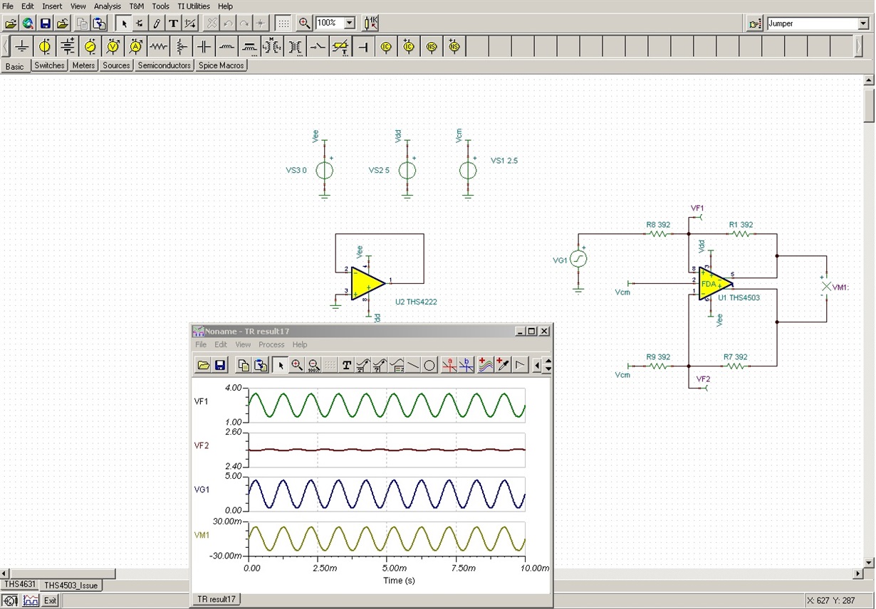

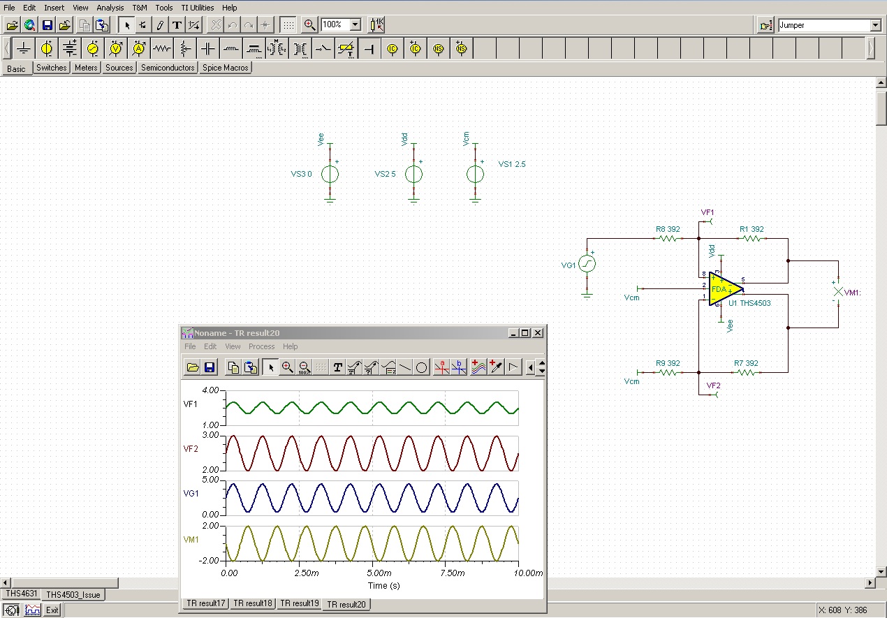

When I implement a single ended to differential circuit using the THS4503 by itself (no other amplifiers, only passive components/voltage generators/batteries), the simulation results seem to be accurate.  When I add a THS4222 amp to feed the THS4503 instead of a voltage generator, the difference output of the THS4503 is 0v (if I zoom way in, I can see the signal is only 100mv instead of the expected 5v).
I have verified the output of the THS4222 in the second simulation is the same as the output from the voltage generator from the first simulation - ie the input to both THS4503 circuits is the same.
Can Tina get confused when multiple components are added to a model?  I will upload a picture of the model and the result output soon.
