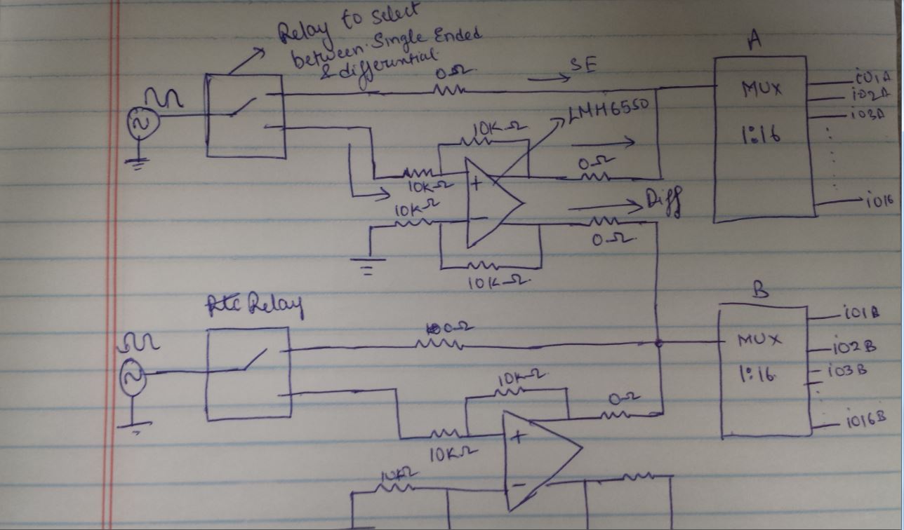

Hi Folks,
I'm designing a board that takes in a single ended signal and going through a relay (SPDT) to choose between going to the input of a mux directly and to an ADC/DAC or converting to differential signal and connecting the positive signal to the same input of the mux stated above. The negative signal goes to an input of a different mux ( as shown in the screen shot below).
My question is that if I'm selecting the relay to send a single ended signal, then the positive input of the opamp would be floating and a sine wave would be seen on the output of the opamp. Is this fine? In this configuration i will be disabling the opamp using the disable pin. Since the feedback resistors will be connected and the voltage gets transferred to the input of the opamp. In that case we shouldn't be seeing a differential signal on the negative terminal, is that right ? Cause i do not want a negative signal going to the next mux.  Can you please tell me if I'm going wrong somewhere?
Also do i need any load at the opamp ? I am assuming that the mux circuit and adc after that would form the load and hence don't plan on having any load at the opamp.
The datasheet for LMH6550 says that in disable state, the output will be at high impedance. What is the value of the impedance (approx) ?
Another question is, i plan to provide 5V supplies to the opamp. But when the ADC acts as a DAC and generates a sine wave, coming out of the mux, the signal amplitude is 9V. will that damage the part? in this scenario, i expect the opamp to do nothing. as i want the signal to go directly through the relay and not through the opamp.

  • Hello Santosh,
    I would not expect the output to be seen coming from the negative terminal, if you have disabled the top LMH6550. Have you confirmed whether this can only be coming from the top LMH6550 disabled amplifier by removing the 0ohm connected in the negative terminal path and not from the B mux? Also, have you made sure that the signal on the B path is completely turned off? Also, could you probe on an oscilloscope the floating positive node of the top disabled LMH6550 to make sure that there is no signal riding?
    Functionality wise, if you are not shorting the amplifier output to ground, the load presented by the adc should be fine.
    The output impedance of LMH6550 in disabled state should be on the order of a couple of Mohms.
    I would not recommend running the LMH6550 on 5V supply and applying a signal amplitude of 9V at the outputs, as it is beyond the absolute maximum rating of the part. The abs max rating is within supply voltage.
    Rohit
  • Hi Santosh,
    The LMH6550 can tolerate up to 12 V supplies, so if you give a 10V supply the 9V from the Mux will be OK.
    The main issue will then be the signal through the feedback resistors to the amplifier inputs.  The inputs are designed to operate with 0V differential voltage, because of this there are back to back protection diodes bewteen the two input pins.  If the differential voltage is large enough there will be signal feed through on these diodes, this could cause issues with isolation.
    Also, it's not a good idea to float one of the outputs, the single ended to differential conversion only works when one of the two inputs is set to a fixed voltage (preferably the same DC value as the other input).
    I would also caution against having the two amplifier outputs connected by 0 Ohm resistors if both will be enabled at the same time.  Load sharing resistors of at least 10 Ohms might be useful.
    Loren

  • Hello Santosh,
    First, I think 10k resistors are too big for the LMH6550 it is high speed and does not tolerate large feedback resistors.  (to check you can simulate with TINA-TI)
    The isolation issue is present even when the amplifier is disabled.  Because the feedback resistors and isolation diodes are passive they will transfer signal around the amplifier in all cases.
    IIt is for this reason that FDA amplifiers are seldom used in multiplexing applications.
    I am attaching a TINA-TI schematic that you can use to simulate different configurations.  Just position the switches appropriately and then you can see the signal flows.  Use a transient simulation, AC simulations are small signal and will not show how the ESD diodes work under large signal conditions.
    You may want to use TINA-TI to simulate your circuit before you build it.  If you are using the LMH6550 on a single supply you need to carefully consider the DC voltages of the inputs and the signal to make sure they are in the valid ranges for the amplifier (roughly 1V from the rails for inputs and outputs, but check the datasheet because the input is shifted down).

  • Hello Santosh,
    The recommendation for feedback resistors is a general observation for high speed amplifiers.  When the feedback resistor is too big the amplifier can be unstable.  I ran some simulations and the LMH6550 may be OK with the 10k resistors, but it is hard to be sure without building a prototype.
    The amplifier will not amplify the signal on the inputs when it is disabled.  The signal path is entirely in the feedback resistors and input protection diodes.  Aside from simulating it in TINA-TI there is no way to be sure without building a prototype.
    One thing to consider is using a buffer (or relay) between the first amplifier negative output and the second amplifier positive output.  This would eliminate the isolation issue.
    Loren

  • hi Folks,
    need your expertise again! I tried to simulate the circuit i was going to build on orcad. the simulation is with the opamp disabled. I have a switch on the positive pin to isolate  the ac signal from going to the input. And i have a AC signal on the positive output pin. Even in disabled state i can see the output on the negative pin. should this be happening?  I've attached the simulation results to show the plots where the probe is placed.
    This is basically what i've tried to implement on spice
    I've also attached the simulation results. Your help is most appreciated!

  • Hi Santosh,
    I think that your simulation is correct.  You will need another relay if you want good isolation.  The amplifiers were not designed for this scenario.
    Loren
