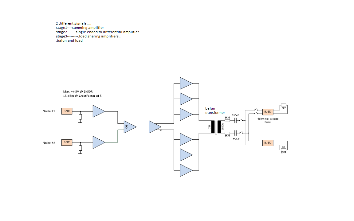

to get a Maximum power or double the Amplitude at my load end I was adviced to use the load sharing concept of op amps. I have read the application note on load sharing amplifiers and developed a schematic like this.Schematic.TSC
I am driving 2 sets of load sharing op amps, to one set I supply +2.5Volts and to the other -2.5Volts. In simulations I can Show that the current is equally shared among the 6 op amps. How to Show visually through simulations that I get Maximum power at my load end or how the power reaching load varies by increasing or decreasing the  number of op amps operating in parallel.
5226.Schematic.TSC
I am failing to understand what happens by increasing the number of op amps in parallel other than load current sharing. I see same Output during transient Analysis if I use 2 op amps or 6 op amps.
I also have another doubt about the resistors to be placed in series with op amps,since 'In order to provide matching to the 50 Ω load, each output has a 100 Ω resistor in series. Looking from the load, these two resistors appear to be in parallel, providing the desired 50 Ω matching.´' this Statement is a bit confusing for me.should each of my resistors be 450 ohms if i am driving a 75 ohm load or should it be 112.5ohms.
My aim is to Show that max power is reached at Output by using this load sharing concept, is there a way to visually Show through simulations how the power reaching load varies by increasing or decreasing the number of op amps operating in parallel, since I am much concerned with power rather than current.

    Can you post a link to the load sharing app note? What is the final circuit or system you are designing? Why do you need to load share?
    Do you need to use terminated transmission line?
    The LMH6552 is not really a 5V amplifier. If you want to run on 5V the LMH6554 would be a better choice.
    Power = V^2 / R Your maximum V is set by the +- 2.5V power supplies, hence the maximum power in the 75 Ohm load is not going to require very much current. I really don't see any need to parallel amplifiers in this application.

    this is the schematic i would like to develop. My target is to achieve a Maximum power at my load end.I want to achieve a wide bandwidth indeed 220MegHertz.
    when asked what is the set of 3 op amps in my third stage, I was said that a concept from TI - load sharing  is used and the purpose of using it is to maximise the Amplitude and to see that max power is obtained at Output.
    but when i read the application note, other than load current sharing, I cant understand how it is reducing the power distortions. I am unable to understand exactly why a load sharing concept is used here.
    some explaination on how load sharing would effect the power at Output would be a great help.

    Unless you need very high linearity (-80dBc or better), I don't think you need to use load sharing for this application. The LMH6552 can drive a 75 Ohm matched load (150 Ohms total). If you increase the supply voltage of the LMH6552 to +-5V you would have more power available than if you use a +-2.5V supply. The LMH6552 works best on a 10V power supply, so this is a double benefit.
    Are you aware that on a +-2.5V supply that most amplifiers will only swing +-1.5V? If you require more voltage swing using power sharing won't work, it only works for current and even then with limits.
    Power sharing works for linearity because sharing current will increase linearity for a given power level. This is because amplifiers give better linearity into a higher impedance load (less current).

    1. With  amplifiers in parallel, the output drive capability increases. In general, the drive capability increases by N (where N is the number of amplifiers in parallel).
    2. If x is the rms power of a single op amp, then adding a second amplifier in parallel increases the RMS signal power by 2x
    3. Paralleling the amplifiers reduces the power dissipation of a single amplifier by sharing the load with multiple amplifiers. The current load on each amplifier is reduced by 1/N where N is number of amplifiers.
     I could prove the 3rd Statement right. I am unable to Show the 2nd Statement (most important for my application the reason for which i want to use the op Amps in parallel). Here is a simple schematic by which I am trying to understand the things.

    "Why is the power always seen same irrespective of the number of op amps in parallel.
     Can you explain me this."
    You are driving the same load with the same voltage, hence your power is the same.  This is basic Ohms law, it won't change based on how many amplifiers you use.
    In order to benefit from parallel amplifiers you need a load resistance that is so low that one amplifier cannot supply adequate current.  You do not have those conditions, hence you DO NOT NEED to parallel amplifiers in your application.

    Rseries should be large enough to ensure that every op amp delivers the same current to the load and small enough that the voltage drop across it does not reduce your system performance.  The exact value will depend on your circuit.

    The absolute maximum current for the THS3091 is 350mA.  This is the current that will damage the amplifier.  Look on page 7 of the datasheet.  You will see that the amplifier can source or sink around 250mA at room temperature, but we can only guarantee 175mA over temperature and process variations.
    Based on this information you would really only want to plan on a maximum of 150mA per amplfier.  If you were using the maximum voltage swing on a +-15V power supply(13Vpp) then the smallest load you could drive is an 87 Ohm load.
    Can you again confirm the supply voltage you are using?  If you stepped up to a +-15V power supply and used more gain in your differential amplifier you could get enough output voltage swing to require using multiple amplifiers to drive your 75 Ohm load.
    More voltage will give you the potential to deliver more power.
