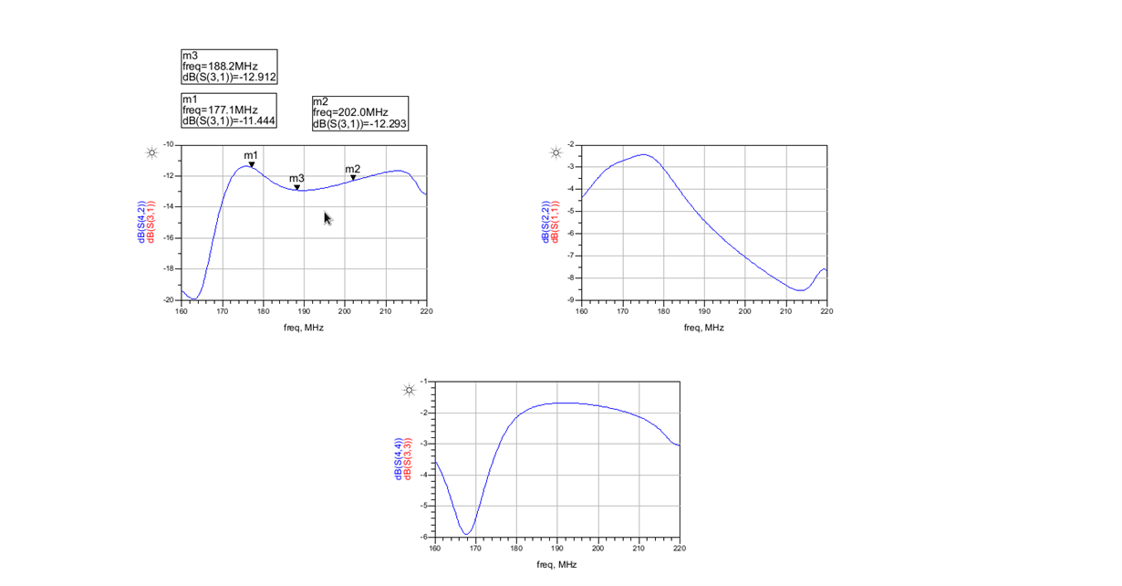

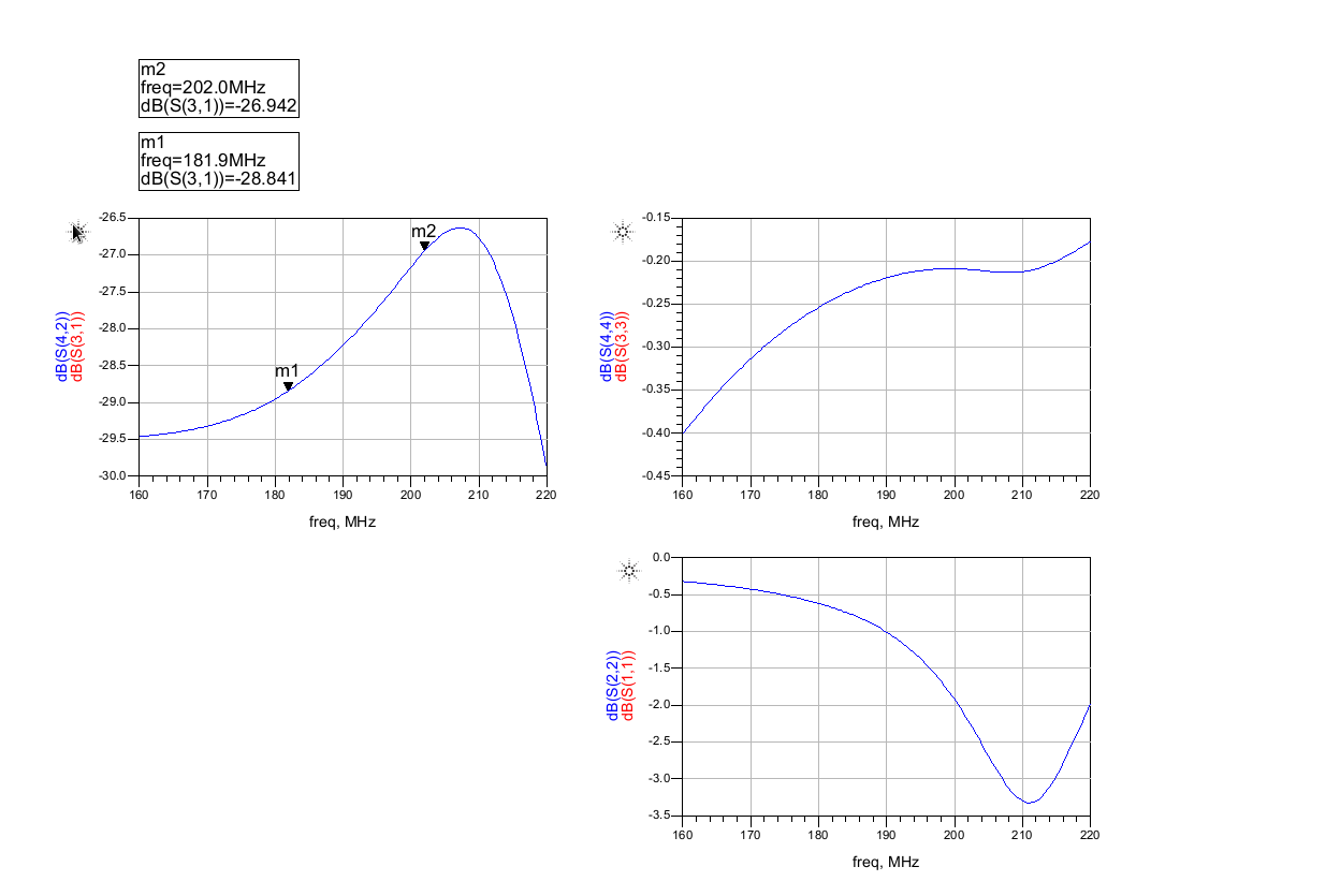

  • Attaching my filter schematic and simulation results :
    As per these simulations, i am getting 1.5dB flatness, but practically on board it comes to be around 8dB. What could have been the reason???
  • Hello Sarika,
    Can you send your board layout? The loss you are seeing looks like either a bad component (cold solder ?)or maybe something with the PCB layout.  There should not be 12dB of filter loss.
    I simulated your filter and it seems to have a peaked response at low frequencies.  This would most likely get worse when put on a PCB.
    I included another filter option in the TINA file that I attached. This filter is 100 Ohms in and 200 Ohms out for lower loss, but still flat response.  It looks like you only use 10Ohm matching resistors on your filter.  This gives lower loss, but has poor matching with most filter designs.

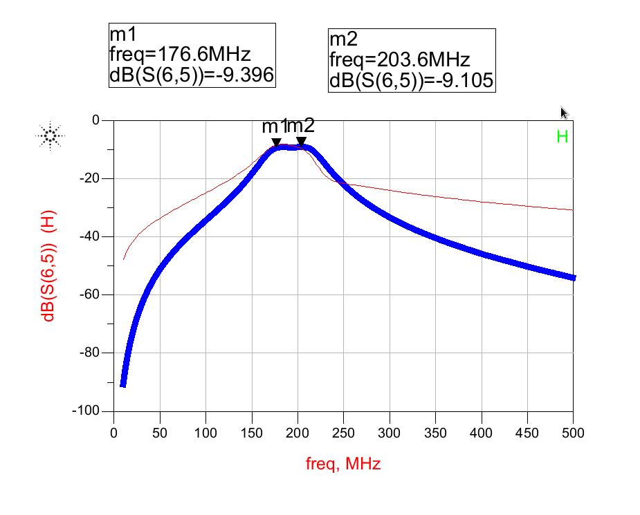

  • Hello Loren
    Thanks for the explanation. I will implement your suggestions and get back to you.
    Meanwhile I tried filter simulations as per your previous mails.

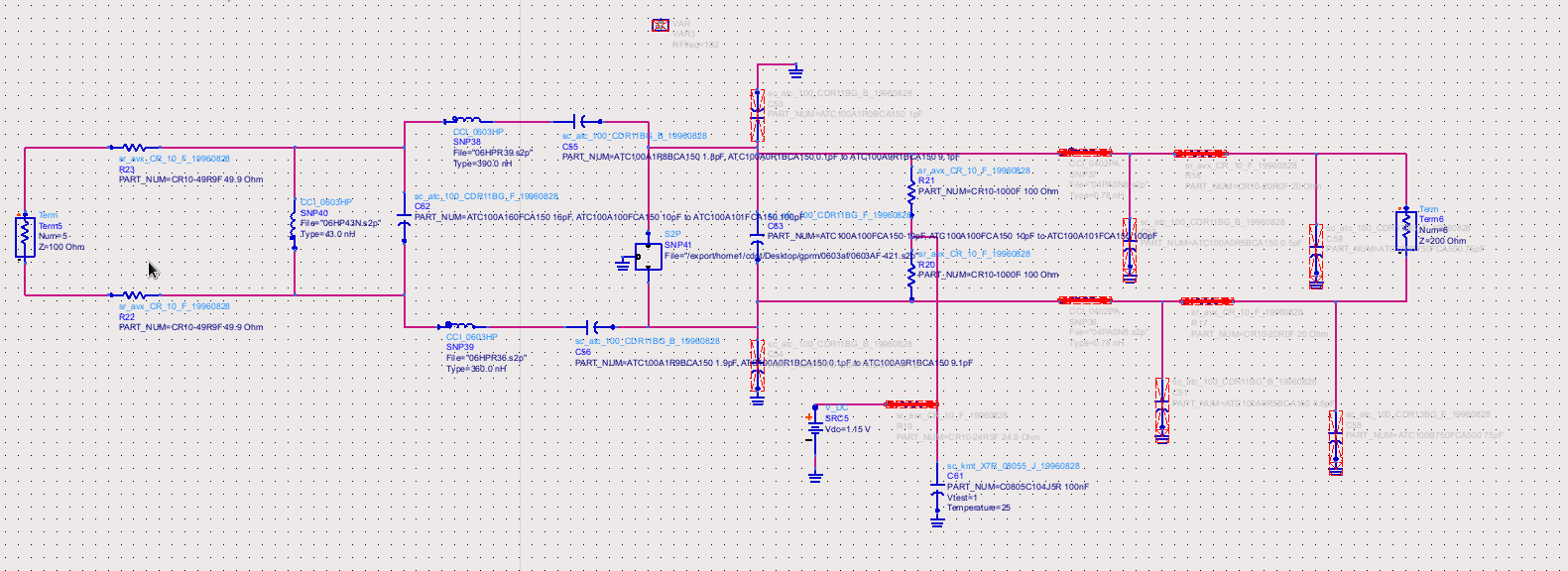

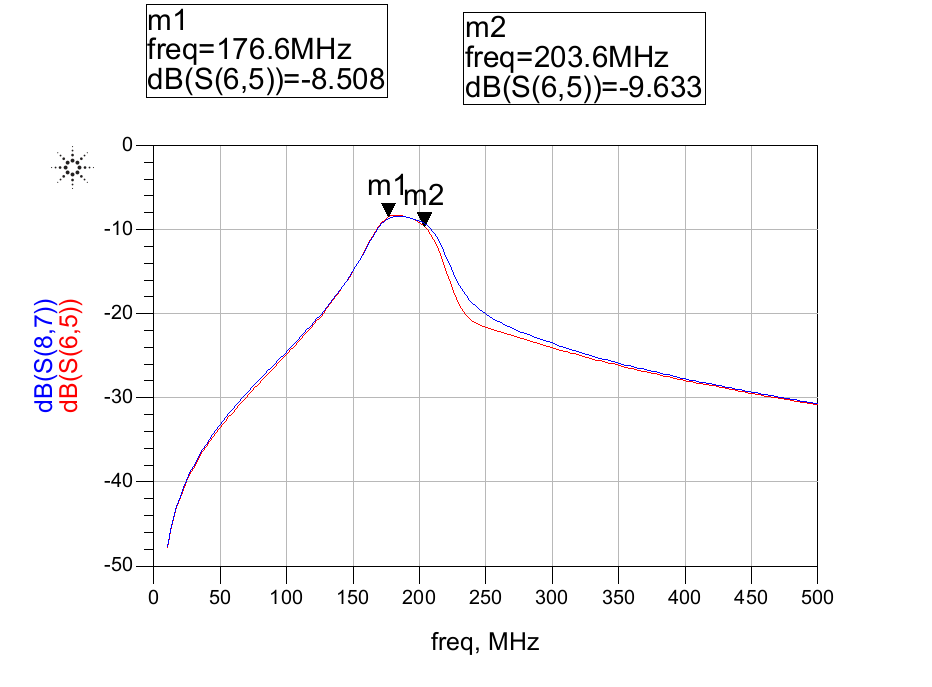

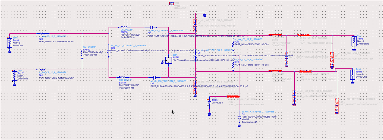

    Attaching two different schematics and their results:
    The difference between these two schematics is the way i kept the terminations. In one I have used separate terminations (50 Ohm input and 100 Ohm output) for all the four ports and in the other I have used one termination for input (100 Ohm) and one for output (200 Ohm) differential pair.
    As you can see, I got different results. Can you suggest me why?
    I felt both the cases are one and the same and was shocked by different results :P
  • Hello Sarika,
    Filters need a particular termination at both the input and the output. This impedance is a design criteria, so you can choose it (within reason).
    The ADC input is very high real impedance with 4pF of capacitance. This is not a good filter termination. We adjust the circuit to accommodate the ADC input parameters by designing the filter such that the capacitance is absorbed by the filter capacitor and then add external resistors to bring the ADC input impedance down the the filter design impedance.
    Loren

  • Hello Sarika,
    The two termination methods are not exactly the same.   With a differential termination there is no connection to the reference plane (typically ground).  This means that while the filter is terminated with respect to the signal path the filter is floating with respect to ground.
    When you terminate each leg of the filter separately you have an equivalent differential termination.  There will also be an another termination component.  The filter now has a tie to ground on each side.  These two terminations, (in parallel) form a common mode termination.
    In your simulations you are driving the filter with two separate sources.  This means that the filter has both differential and common mode components in the drive signal.
    I am pretty sure that if you drive the filter with a differential source the two termination options should show the same response.
    Loren
