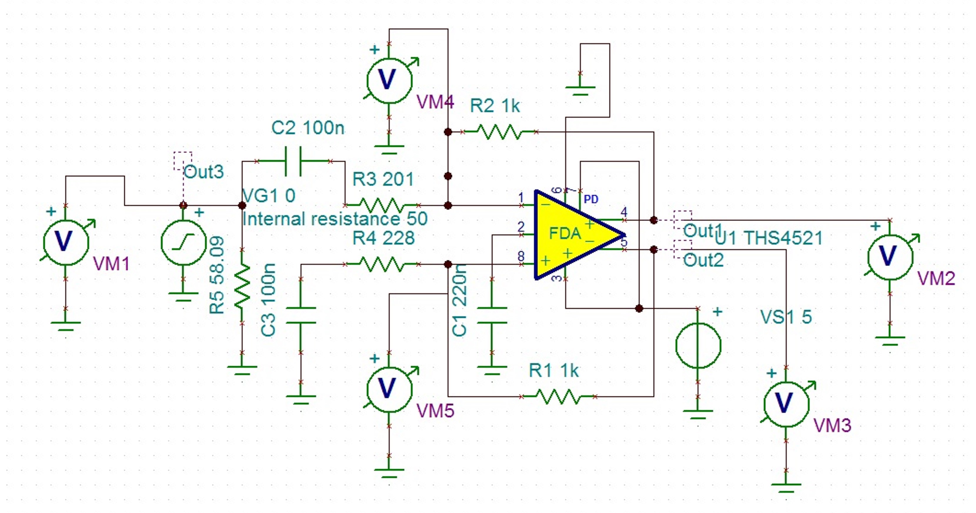

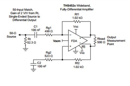

    Sorry for the late reply. I have attached a picture of my circuit below (I have ac-coupled the sensor) and I am trying to amplify signals from a piezo film sensor. The initial problem was that when I was attaching the sensor to the amp. the signal from the amplifier was just dying out (the signal was fine when I detached it from the amp and checked the sensor alone). I have fixed this problem by ac-coupling and putting a very high value resister at Rt, however now I get nothing at either of the differential outputs. Can you please advise how I can approach the problem.
    Values used for the circuit below are: Rf1 = Rf2 = 1kOhm, Rg1 = Rg2 = 220 Ohm, C1 = C2 = 100nF, Rt = 3kOhm (For a low value of Rt about 50 Ohm the input from the sensor dies out giving the same problem as before)

  • Hi Samir,
    The signal I am trying to amplify ranges from 50-2000Hz. I am providing the sensor with 5V and the amplifier circuit rails at +5V and Gnd.
    I have simulated the circuit in TINA and have an idea as to what might be causing the input from the sensor to die out. Have a look at the circuit diagram in TINA and two simulation results from TINA.

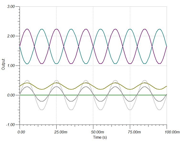

    This is the output for the simulation assuming the sensor internal impedance(labelled Internal resistance in the above schematic) is low at about 50 Ohms. Where the cyan and purple waveforms are the two differential outputs VM2 and VM3. And the olive coloured signal is the dc biased input signal to the amplifier. As you can see below the input signal is not squished and the output correct.

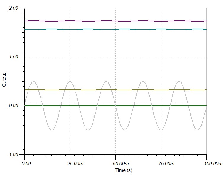

    However now if we put a very high internal impedance for the sensor at about Internal resistance = 10kOhm and run the simulation again you can see that the input signal provided to the amplifier is squished and the outputs are amplified but also squished.:
    Do you know how we can amplify the signal from a high impedance voltage sensor?
    -Zain

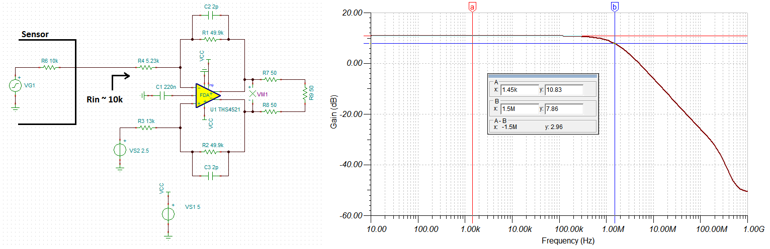

  • Hi Zain,
    I would not recommend using the 100nF ac coupling capacitor, as it will attenuate the signal frequency in the range of 50-2kHz. Based on what you are describing, it seems like you would need a high input impedance amplifier on the range of 10kohm or higher to amplify the signal from a high impedance voltage sensor. Here are two suggestions that you could try:
    1. You could try to increase the input impedance of the THS4521 using the Circuit 1 below and see if the output signal is restored. In the below Circuit 1, I have used a feedback capacitor of 2pF across the 50kohm feedback resistor for stability purposes. You might have to tweak that depending upon the input parasitic seen across the Rg resistors on your board. One thing you need to be careful is to provide the same DC bias voltage on the un-driven side of the FDA as that available from the voltage sensor, so as to not have a large DC offset at the FDA outputs. I have attached the TINA-TI schematic for the same: THS4521_HighImp_Sensor.TSC

    Let me know if this works.
